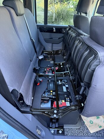

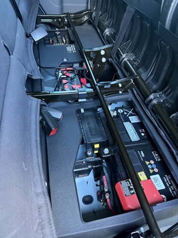

I would like some guidance on removing the rear bench of my grenadier wagon.
I want to remove the second lead acid battery and replace it with a LiFePO4 battery that will run my fridge.
Thanks in advance.

you do not have to remove the rear seat to remove the battery .
You can remove the plastic shroud from around it, unbolt the hold downs
and then slides out underneath the seat .

Good point @Tinki, and a much better answer if @CRANO was only doing a battery change. He says he's converting to a lithium aux battery so he's going to need to pull out the battery combiner (ctek) and the interconnecting wiring then find space to install a replacement dc-dc charger. For that he will need to get some more trim out of the way. Two choices there: lift the seat (or at least unbolt it and tilt it back) then the trim pieces will come out easily; or wrestle the trim out with the seat in place. Having done the latter, I think lifting/tilting the seat would be much easier.
The Agile twin air kit instructions provides info on partial trim removal. This might provide enough access for Mark to do what he needs.
