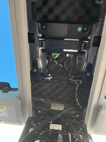

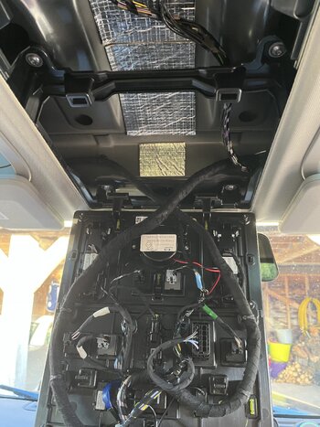

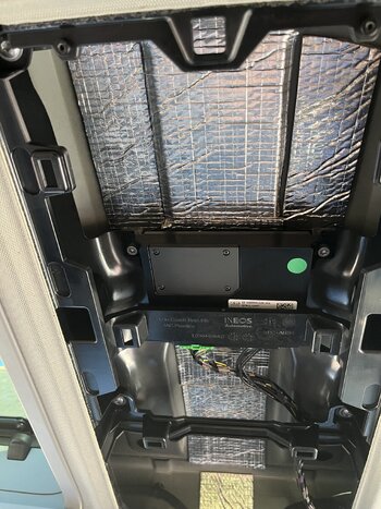

Today I removed the panel and fitted some sound deadening and sound absorption materials. Currently, my hands free experience has been mixed. Always easy to understand but sometimes I have complaints concerning quality of the call. I am hoping that reducing resonance around the mic might help. Will update over the coming days.

I see there is a microphone to the E call? Where is the microphone to the infotainment system located, do you know?
I might try the sound deadening route just to tinker. Personally my hands free experiences have been good. For example, yesterday I had all the windows/safari open and going @45-50mph having a conversation. Asked if my friend could hear me OK, and he could 🤷🏻‍♂️
Maybe the climair front deflectors help smooth the air around the mic or something, IDK. I also have the seat jacked pretty high and at 6’01”, I’m also much closer to the mic with the seat in that position.
Interesting to see how it goes, although I don’t have an issue with mine. I personally would also insulate the microphone wire with some open foam tape and maybe zip tie some of the harness back so it doesn’t touch the back of the mic. I believe there should be another connection where the wire meets another socket down the line, I would insulate this too.
