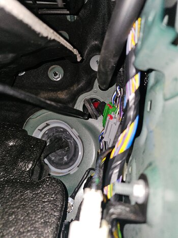

How did you route the wires from the bonnet into the cabin? Was it straightforward?

Here is a picture of where I ran my Lensun cable thru the firewall. Hope it helps!

I looked at that picture, i think you should put some more protection around those cables. Without the grommet in place i think there is a high chance of rubbing against the steel edge in the firewall
Just carefully split that grommet and put the wires inside of it. If you want to get extra fancy seal the grommet with RTV. More specifically we use high temp RTV in aircraft to help slow a potential fire. But that's overkill here.
I actually ran it through the grommet to protect the wire and seal the firewall. I was just showing the access point I used with this picture.
I did actually, this picture was just to show the grommett location I used to run the wiring thru the firewall. When I wS doing this originally, no one had a picture of the access point they used.
