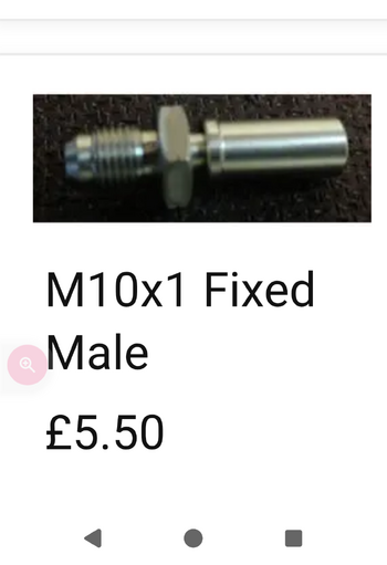

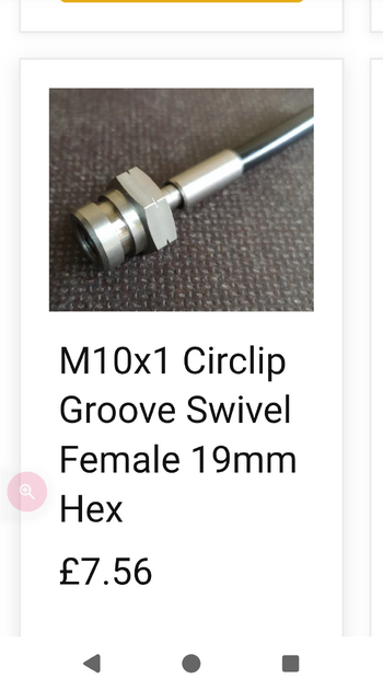

OK, let me help you out... I am assuming you are looking for a trail repair
1. There are 6 Flexi hoses.
2. All fittings are M10x1
3. The 4 to the wheels have a male at one end and a female circlip fitting at the other.
4. The two extra ones on the rear axle have female circlip fittings on both ends.
5.The right side ones are the same as the left ones
Some pictures:
M10 male
2 suggestions:
Go to this site and select M10 male and M10 female, selecting the right length of course. About £20 each.
My suggestion however is this_
Go to car builder solutions under self assembly brake lines.
Buy a length of braided hose about £8
Buy some fittings, about £5 each.
You will then be able to make up lines if you damage them. Dead easy as per this video.
View: https://youtu.be/5tdsgZ-KfWI?si=kWijwBV9Myqd8u30
It will save a lot of space and money, you might even be able to help out a fellow traveller as this stuff is pretty standard.
