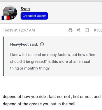

Super cool that the new driveshaft has a Zerk fitting so it can be greased. Sorry for the noob question, but how does one know when it actually needs to be greased? Is this a visual inspection every few hundred miles thing or is it safe to do, say every 5k miles or so?
Reactions: CRH
Sven should know, he made it 😉
