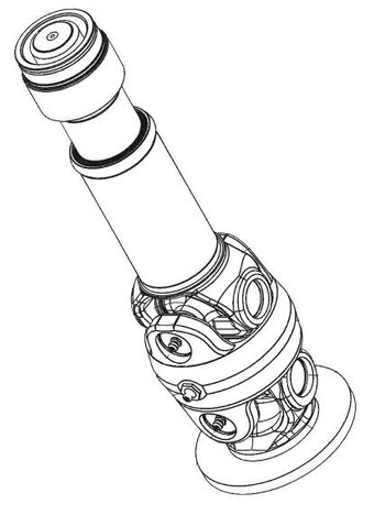

on my one , the grease nipple is on exterior , really easy to do

For the u-joints the grease zerk is obvious and it looks like the grease point for the centering ball is also easily accessible. Well done Sven.

Sven,
Once again thank you for sharing your expertise.
Please explain how the grease travels to the centering ball from the zerk on the outer cage of the double cardan?
Versus traditional needle tool greasing the center ball.
Your design simplifies maintaining good operation between checks and servicing.
