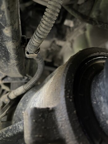

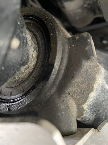

Question here related to any indicative “noises” with regard to this…
Shitake has the drivetrain vibration issue that was almost remedied by the dealer loosening everything around the T case mounting and “releasing some tension” in the setup. It did return however but is bearable.
However….
Last trip home from the mountain we noticed a significant change in this harmonic extra! Just more of it to be exact, and also intermittent.
Had a good look around underneath and can see no obvious curclip damage or boot material breakdown so 🤞🏽 I’m ok for now.
Happened to see this seepage around the front diff and wondered if this could have been causing the noise if oil level low but it really doesn’t look too bad - a little oil goes a long way as is said! Plus I’ve already had the rear one replaced and was advised that driving was ok if I keep an eye on leakage and oil level. (Which is pretty tricky now the skids are in place 🙄)
Anyway my main question is - what indicators should we be listening for or feeling, to indicate an imminent problem?
Cheers Team 😁

Just a little follow up question..
Seems this prop shaft / drive shaft seal issue is quite common as @Jeremy996 just mentioned in another thread so not overly worrying.
On the oil level side, as it’s pretty hard for me to check easily being away and moving locations plus diff protection fitted and with limited tools to hand 🙄
Am I safe to assume that without drip evidence underneath or any noises, can I use CD temp as a very rough guide to oil usage? I’m assuming I can but 🤷🏼‍♂️
