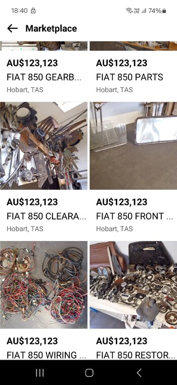

Sold the wife's 67 Fiat 850 spider yesterday. The dealer could barely fit all the spares on his truck, I then started to tidy the garage and found more, and I know there are some in the shed 🤣
I am not starting again with the Grenadier!
Local FB marketplace; not much is shifting in the past 3 years it seems
