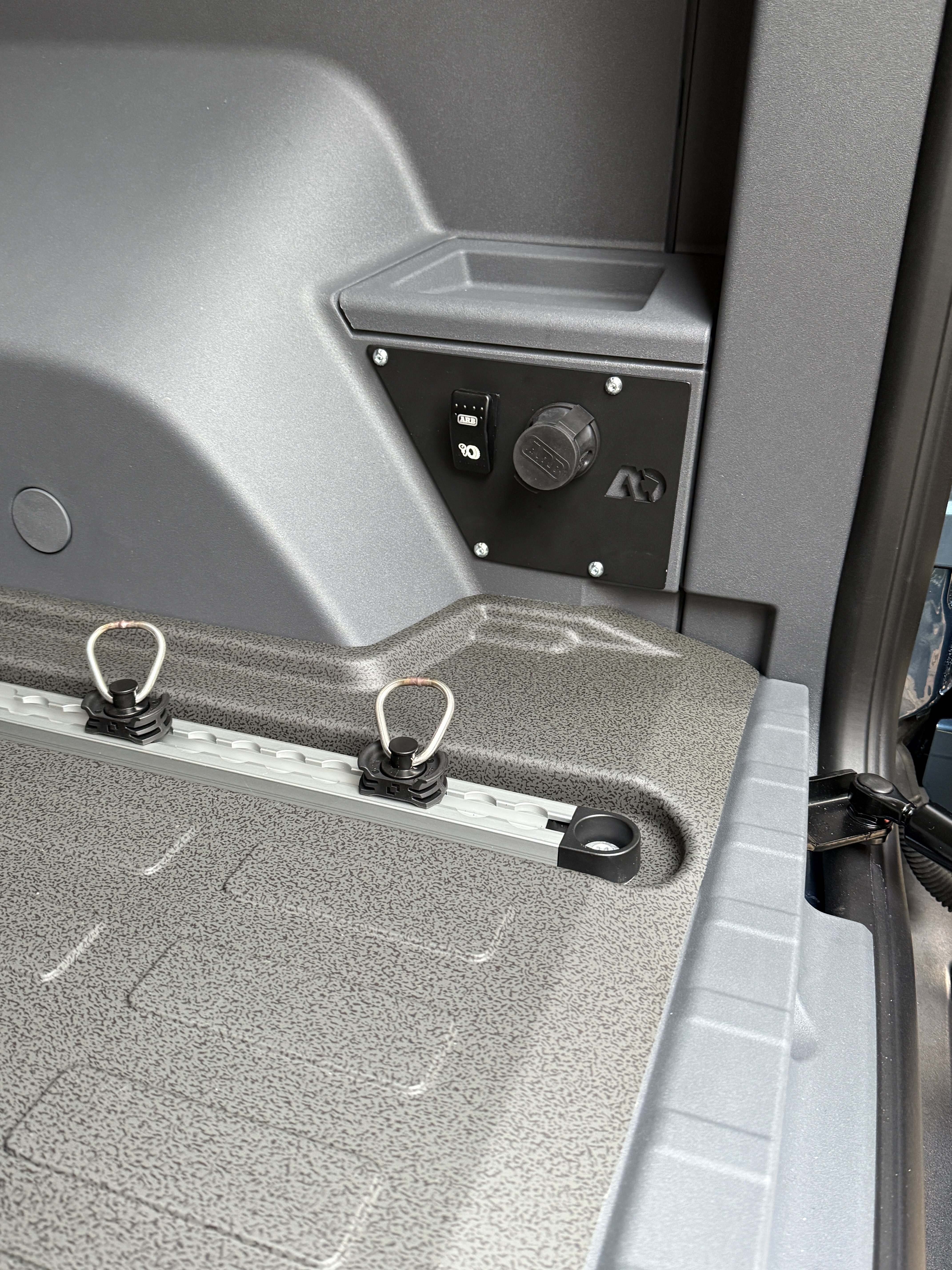

I like the location of the Owl bracket, its a clever use of that space. I’d rather run the trigger to INT1 and use that to tie to ignition. But then there will be the hole in the bracket where the switch should be which would look crappy, or just put the switch there without wiring it up. Maybe I can rig up a blank for that hole.

Outlet and switch under the rear seats left and right (next weekends work):

I decided to go with the Agile Offroad ARB single compressor under the rear seat kit.
I am really happy with it so far. Was a bit intimidated about doing the install myself- was very nervous about taking the interior panels apart without damaging them.
Fortunately the instructions are very thorough and also found a youtube video walking through the install. I took my time and it was around a 4 hour job- but now that I have done it could probably get it done in 1.5-2 hours pretty easily.
It is wired to one of the battery busses, and has a switch wire that goes into the fuse box so the pump is keyed to the ignition for use.

Heres the video I referenced. The included instructions show installation on a Grenadier without the Auxiliary battery. My truck has the second battery so it makes the install slightly more difficult. I found in the end it was easier to just remove the Aux Battery during the install which gives you much more room to work, route the wires, mount the compressor, and run the air hose.
Also highly recommend a helper when fishing the wires and air hose through the paneling towards the back of the truck. It would have been very difficult to do that part of the job solo.
Nice solution, but dons‘t it rattle when operating?
No, no rattle at the moment. if it appears I will add 4 silentblocks to dampen the vibrations.
