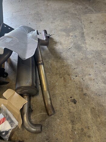

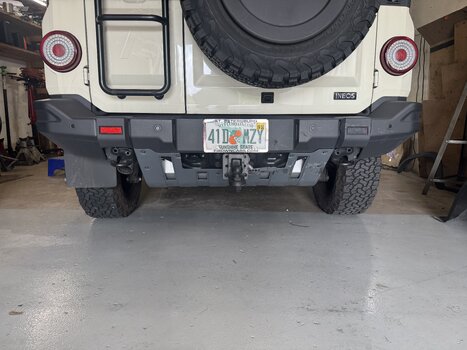

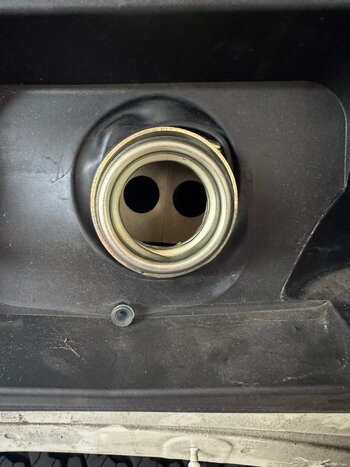

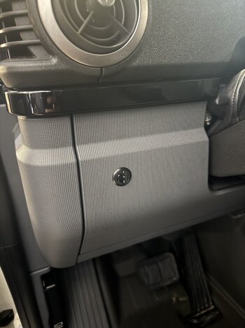

And it is done, long range usa fuel tank install. Mechanic said very straight forward, easier to do on Ineos then it was on my GX470.
Driving down to the keys Saturday. Will put it to test.
I attached finished look with single exhaust change. As well as fuel fill and transfer button.

I received mine but not installed yet. I was thinking about trying to take it to a Long Range America installer, but if you say it was a relatively easy job, I might see if my local guy can do it for me...
Are you doing the install yourself, or are you working with an installer?
Noooo nobody wants me to be installing a fuel tank... It's being installed by Apex Overland in Reidsville, NC, they're my go-to for everything
From when I installed my LRA on my 200, it wasn't a difficult install and LRA provided decent instructions and were happy to answer questions. Use a floor jack to lift it into place.

How is the exhaust sound especially on the highway?

When I put one on my 200 Land Cruiser, it squeaked whenever the body flexed because the tank was mounted to the frame, but snugged up against the underside of the body.
I dropped it down a bit and inserted little rectangles of HDPE sheet (starboard) between the tank and body.
It has been silent and has worked flawlessly ever since!
Easily one of my favorite mods on the 200.
Just a bit growly-er; biggest difference is high RPM and/or outside the vehicle

For what it's worth, Apex Overland in NC charged 7 hours for the install
About the same for me.
As for exhaust, more throaty and deeper. im curious if it will move the needle on mpg😂😂 always hopeful🙏🏼😂
Will report after drive, this weekend. So far in town gas been doing great. No issue. My GX470 tank functions as a overflow until it goes down to 3/4 on aux tank. Then it functions as aux tank.
This one does not do that at all. And fills up all the way easily.
