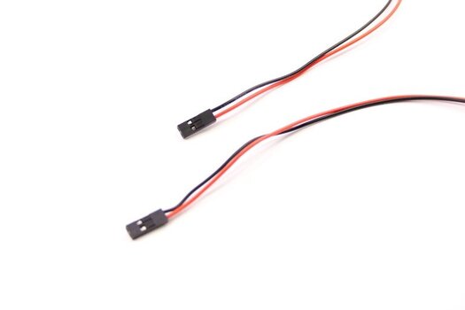

I bought some Morimoto lights and them came with a pigtail harness (just 2 wires and a plug - a similar setup to below)
I am planning to crimp on the Deutsch DTP-Series 2 Way Male Plug Kit by Agile Offroad and plug them into the roof power mounts.
My “I am new to this” questions:
1: that is all the kit I need, right? I don’t need breakers or relays or anything else? When looking at front mounted lights they seem to call for more bits and bobs.
2: should I wrap the wires in that heat shrink tube stuff so that it’s not exposed to the elements and doesn’t catch on anything?
3: Does it make sense to - eventually - run multiple lights from one power point so that I can free a plug up for some other purpose?
Thanks in advance!

That's all you need
I've wrapped my wires as using black tubes to resist UV light degradation
I don't know how many lights you can run off 1 socket but I'm sure more than 1, but don't take my word for it. 1 of the 4 sockets is on a different switch for the front mounted roof light

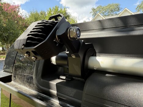

I run 2 pod light off 1 plug on each side to keep one plug open on each side.
Problem is there are not 4 switches for 4 plugs. There’s 2 switches, so freeing something up may not be as useful as you think, or you’ll at least have to manually unplug cables to only use a specific item, so you could just as easily use the same plug.
One switch does the front left (I think) and the other switch does rear left and both right side.
Upvote 0
Here you can see both lights plugged into the front plug. I have one light facing straight to the side and one angled backwards, but not completely rear facing. It lights up very well.
