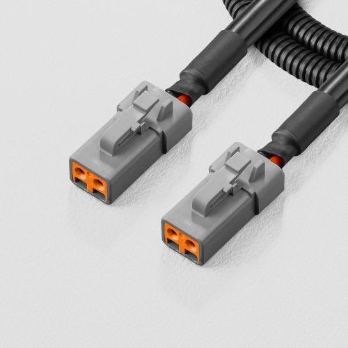

Team, this is just a quick call out for some help. Has anyone seen a DTP extension cable with an inline switch so that a number of accessories can be used via the roof power outlets while being individually switched? I have work lights on the left and right sides, together with the factor LED front lightbar. I wanted to install a Starlink mini and a rear work light and be able to switch each of these on and off individually.
I have these components :
It allows me to power the starlink; however, all accessories must be on as they are all switched on the overhead panel.

Hi Andy,
I can‘t provide you with an inline switch, but what about a Garmin Powerswitch?
Switch Pros is another option.

I have seen a DT version, not a DTP version. Maybe look further at OEX.
@andrew.roberts, if you are interested in the DIY route, I solved this issue with a short DTP to DT conversion cable from one roof power outlet to a three way DT splitter cable and adding inline waterproof switches to each of the three branches - details here.
Thanks, Jiman01...looks really good. now I just need to work on where to install it and the grounding the accessories. Have you installed this product ?
I have not. I’ve installed similar units in other vehicles but I’m still undecided on the Grenadier.
Agile Offroad has a cool mounting solution if you don’t mind it being mounted to you upper switch panel
