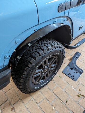

Here's an old pic of my vehicle with the right rear flare removed. There are studs attached to the body and steel clips embedded into the flare. I don't have a pic of the inside of the flare to see what the clips look like.
The door trim card clips are plastic. I have a bag of those on my bench. Different item.

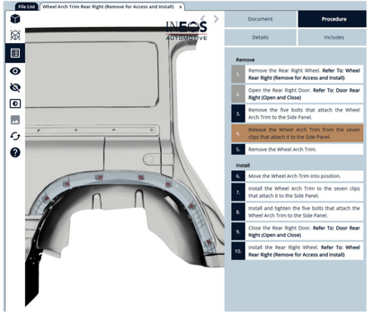

The front flares are held on partially with the black plastic clips that attach to the fender and the metal clips that attach to the inner fender liner.
I believe the panel clips TheDocAUS linked will work but are slightly different. The door panel clips are entirely different.
So for clarity, they are all different parts:
  • The door trim clips have a dust seal and a male prong that clips into a hole in the door
  • The front fender flare clips have a male prong that clips into a hole in the fender
  • The rear fender flare clips have a female socket that clips over a male weld stud on the body
Door trim clip: GRA-0000-038210
Rear fender flare clip: GRA-0000-006500
Front fender flare clip: GRA-0000-005780
Door trim clip
Rear fender clip
Front fender clip
