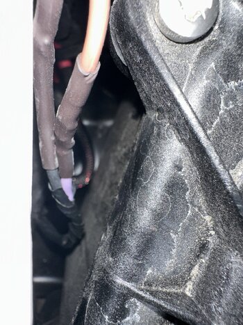

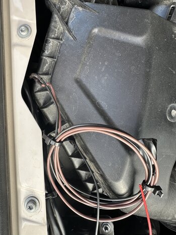

Well after 3 visits to the dealer they finally located and extended for ‘free’ the ext 5 wire …
Can’t even see where it is and certainly required removing parts to find it
The 10 and 25 circuits are now at the same place
Photo of the area and somewhere down there is the other end

I think you won the prize for the most difficult EXT5 wires to find. That looks like a factory mistake.
