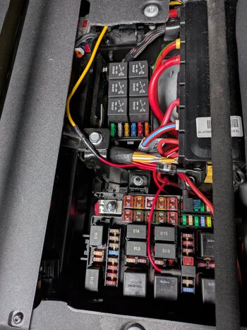

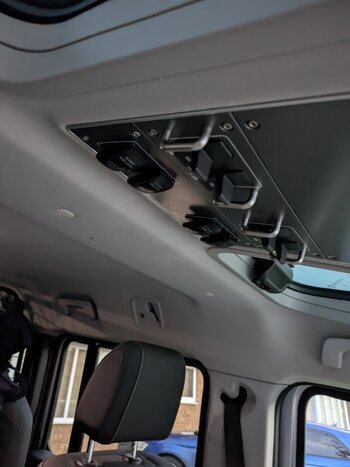

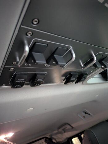

A brief outline of what I did.
- added 4 switches to the panel.
- added a standalone fuse box near the battery
- ran wires behind the headlining and B pillar
- made a hole in the plastic behind the exterior grab handle and ran the wires through to the roof (grommet and RTV'd)
A couple of pictures. The relay box wasn't finished in the first picture, I would have used the Ineos toggle switches in the next pictures if they were available.
