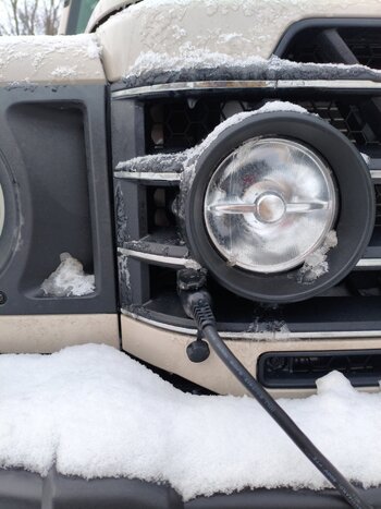

The cabin heater has been fantastic, and i love the app. I mounted the heater under the passenger seat. I ran the wires on the passenger side, from the battery, to the heater, and the 120v plug at the front of the car next to passenger side fog light. There is a big grommet in passenger side foot well at the fire wall, that had plenty of space. I also spliced the cable to make it long enough to reach the front of the truck.

Here's where I mounted the front plug!
