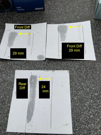

After about 23,000 km, I've changed the oil in my differentials a total of three times. The first time was because the dealer forgot to do it, and now to take the measurements.
The factory oil level was 2.1 liters at the first oil change.
Today, I filled both differentials with exactly 2.1 liters. The oil in the front differential was afterwards 29 mm below the filler hole, and in the rear differential 24 mm below.
I measured the oil level with a wire hook, which I then drew along a line on a piece of paper. This makes it easier to see the oil level when the oil is new and clean. Both differentials were cold when I took the measurements.
To see how much oil was actually going into the differentials, I tried overfilling the rear differential before draining the old oil. After I had quite laboriously filled it with about 1 liter of oil using a squeeze bottle, I stopped and measured again. The oil level was now about 10 mm below the filler hole.
I then drained a total of 3 liters of oil from the differential, and there were still 10 mm to the filler opening. I suspect that at least 3.5 liters of oil can be poured into the differentials when filling to the overflow.
When researching online about changing the differential oil, all you ever find is the advice that they should be filled to the overflow. Since Ineos differs from all other manufacturers I know in this regard, I wish they had given some information about why their differentials should only be filled with so little. Perhaps someone should ask Lynn Calder this question.
