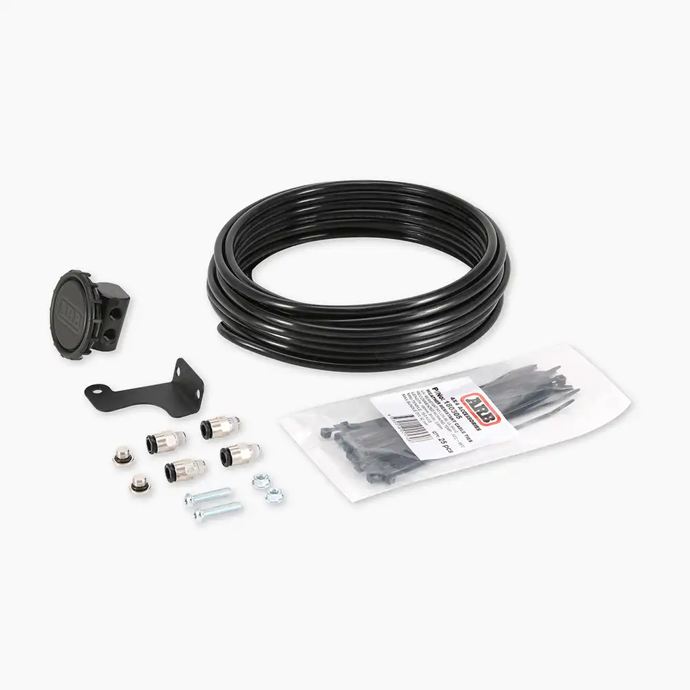

Please do not do this. It is old school thinking (nothing wrong with that usually) but overfilling the diffs in the IG will result in over pressuring the cases unless you opt for old school vented housings which will cause them to leak.
I'd love to hear your explanation of this. Please site information if you could please.
Heat equals friction, friction causes pressure, pressure causes leaks. Your 1990 F250 has an open vent. Your 2024 Grenadier has a slintered vent that is not open and prone to over pressurization when overfilled and when overfilled causes leaks, it is a known issue.
Do a DIY vent or something like this if you choose to be old school. Oh, and don’t a such a millennial unless you know of what you speak.
I assume you mean sintered vent? Are you familiar with what those are? I assume you're suggesting that the sintered vents get clogged over time since it's allowing air in and out? Sintered vents used as bi directional vents can easily clog to be sure. They are typically best when used as exhaust only. So, yeah if your vent gets clogged you will have issues. Won't matter how much oil you have in your diff. A clogged vent has nothing to do with proper oil level. Unclog your vent as part of regular preventative maintenance and all is fine. Or feel free to add some extensions with or without goofy K&N filters from Pep Boys. Your call, but doesn't change a thing in regards to oil level.
And trust me, I very very much know what I am talking about. You my friend, I'm not so sure about. I'm certainly not sure why you think I am a millennial. I was already a Land Rover tech when many millennials were born.
I assume you mean sintered vent? Are you familiar with what those are? I assume you're suggesting that the sintered vents get clogged over time since it's allowing air in and out? Sintered vents used as bi directional vents can easily clog to be sure. They are typically best when used as exhaust only. So, yeah if your vent gets clogged you will have issues. Won't matter how much oil you have in your diff. A clogged vent has nothing to do with proper oil level. Unclog your vent as part of regular preventative maintenance and all is fine. Or feel free to add some extensions with or without goofy K&N filters. Your call, but doesn't change a thing in regards to oil level.
Best of luck to you.
Not sure if you have actually checked, but my Grenadier had what looks like poppet valve breathers (spring loaded plunger with seal). I've since replaced them with remote breathers and zero leaks.
eh?
i'm corn fused. ....
heat (T) is caused by friction (u) . i can't take an equation and directly substitute friction for heat. and how does friction "cause" pressure, that's heats job? ln(P2/P1) = (ΔHvap/R) * (1/T1 - 1/T2). I'm not seeing friction in here. ironically, diff fluid mitigates friction, as that's why its there in the first place. I'm not certain how 4 more oz of fluid is going to cause friction and therefore heat. The only way more oil could be a functional part of your theory, would be the ΔHvap, but if it really was that much pressure (which its not, btw as more oil would be a heat sink as it touched the casing) that's what the valve is for. so, if your seal is leaking from pressure, its not the fluid, its the breather not working, and more fluid will not cause a breather not to work as it cannot be filled to full or close to it. the location of the fill hole is deliberate. notice its not on the top? its where it is so it cannot be overfilled and prevent any sort of drag or foaming. the gear needs to slosh thru it and spray it, not be submersed in it. plenty of space is maintained.
