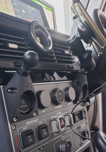

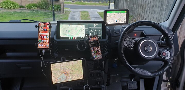

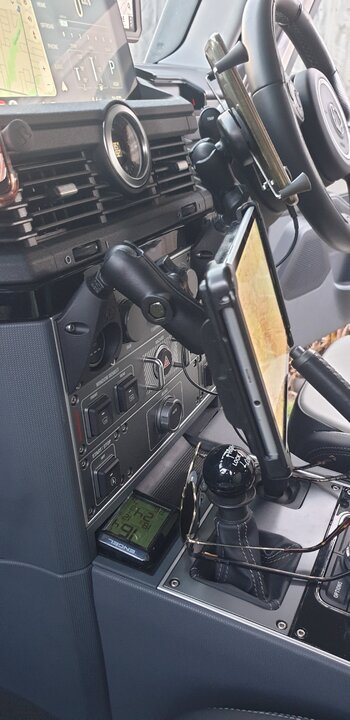

I’m in Oz so I imported two Agile Offroad Grenadier GH Dial Mount kits (AO-I1G-02) and fitted them to my Grenadier. Three RAM mounts hold the passenger and driver phones and a 9” tablet. The phones use RAM Large X-Grip Phone Holders (RAM-HOL-UN10BU) and the tablet a RAM Tab-Tite Cradle (RAM-HOL-TAB24U). All using RAM Standard Double Socket Clamp Arm B size (RAM-B-201U). The passenger phone uses a RAM Round Base with 1” Ball (RAM-B-202U) screwed to the dash. This creates what I believe is a legal phone mount system for the driver (Australia, State of Victoria laws as of July 1, 2025).
The tablet runs Memory-Map-4-All among other things and only comes out on trips as needed. This then compliments my Garmin Overlander and gives me 3 alternative mapping programs including Google Maps.

Interesting idea there. Are the Dial Mounts solid when in place? 3D printed?
G'day, The mounts are very solid when in place. I do not think they are 3D printed. There's a seam line around the casting so perhaps not. Although I do not really know as they are made by Agile Offroad.
They sure look solid.
Agile Offroad' website states:
The Agile Dash Ball Mount for INEOS Grenadier is constructed from ultra-sturdy ASA resin and mounts seamlessly in place of the OEM INEOS Grenadier or Quartermaster seat heat button dash bezel on driver or passenger side.

Looks great, just got mine through today just trying to figure out what the really long bolt is for in the pack . I take it,it will become obvious when I get to the install.
They are similar in fitment to the kit that the forum store has. One bolt is longer as that’s the one that secures the instrument panel to the vehicle. The remainder are more or less for looks. It secures the mount to the panel and not the underlying frame. If you’re concerned, have a look at the instructions for the forum kit in the resources section.
Just be careful how much weight you put on the mount when installed.
I've had the exact same kit from agile on my car since it came out. Same setup, a tablet and my phone
Been super sturdy for me.
Reactions: PBD
The long screws are for the inner lower location. Yes, very apparent when you remove the existing. Hope it goes well. Cheers Pete
