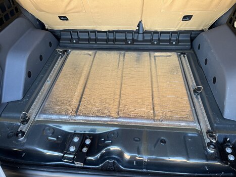

Started applying sound deadening material in the boot area. I think the seller said something between 50% - 80% coverage was recommended. Currently studying how to remove side panels without damage, before completing the install.
Will report on the difference noticed, as I progress.

It makes a big difference.
Not sure if it is my imagination, but already seems to sound quieter.
You sure did take your time with the roller. I could never have that kind of patience 🤣
Do you remember how much Dynamat you have used for the entire cargo area?
I do a lot of it so I buy the Installers pack from Dynamat. Its 4 sheets of that per back area. What i usually do is measure the area, width by length of the area you want to cover and multiply by 1.3 and that will get you some extra for the odd shapes and ridges.
