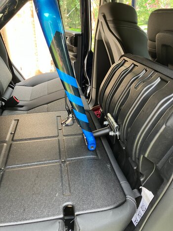

I ended up with the Kuat racks: Piston Pro 2 bike and the Pivot V2 (swing-away). Additionally, I mounted a Kuat Dirty Mount fork mount to the interior 40 seat underside when I am carrying just one bike or 3. I attached a hinge to the underside of the seat so that the fork mount rack could clear the seat back when folding, and is positioned so that it clears the seat bar support when lowered. I could not get the plastic panels off the seat back or underside, so I went with anchor bolts and short screws. Not a perfect installation, but one that will work when called upon. Will post a pic of the Kuat rack system the next time I have it on there. I also opted for the swing away to the passenger side instead of the driver side for the Pivot V2.

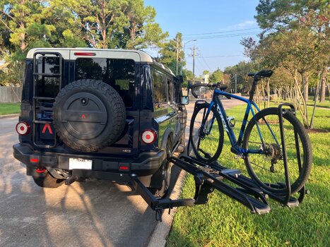

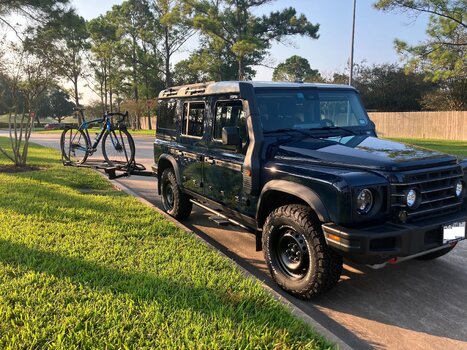

Back in July i had posted a picture of my interior fork-mount Kuat rack. Here is the exterior solution, using Kuat Pivot and Kuat Piston Pro rack. Has ample room/clearance to open the larger / right side rear door. Definitely a much better solution than just the Kuat Piston Pro with a rack extension. Pictures show the rack in the "open" position.

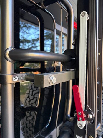

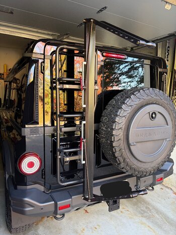

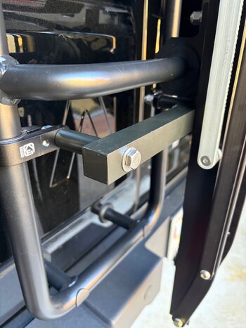

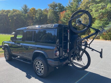

I recently purchased my 2025 Grenadier and I am also an active MTB rider, getting out 4X week. For me, I wanted a way to hold my MTB without blocking the rear doors so I purchased a 1 Up and then customized a way to attach it to the rear ladder while still being able to use the ladder for roof access, see images:

Interssting.. but I bet the 1up mechanism was never designed to have the full weight resting on the rear wheel lock arm
Correct, I doubt it was designed for the weight, so what I did was add on a ProGrip 1/4' XRT Rope lock tie down, about $13 at HD and rated to 150lbs. I hook the top to the ladder and the bottom to the last hole in the bottom of the 1 Up, this way it reinforces the 1 Up so it wont release. Been riding with it for a month no issues.
A fork style mount at the top of the ladder plus a tray & strap for the rear wheel at the bottom would be the ideal vertical setup. The 1Up is definitely not designed to mount vertically and will likely fail in time even with the reinforcement strap. This is not to disparage 1Up. Their racks are great and what I use for my bikes in the standard horizontal position.

Owl vans has been mounting 1up trays like that for years and years. They sell a reinforcing cable to support the lower arm that works very well. I wouldn't worry about it at all if using a cable or strap to support but I definitely wouldn't use it without a support.
