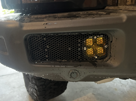

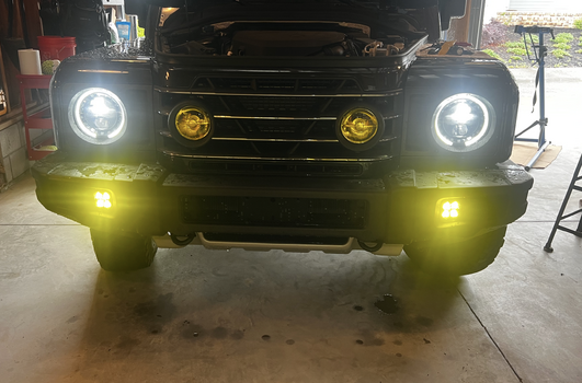

I did. A few hours of work and a few holes to drill. Hardest part was wiring to the (far too short) AUX1 wires in the engine bay. It's hot here in the Summer and no perceptible increase in oil temp even in stop and go traffic. These are SAE fogs from Baja designs.

Huh...Baja design, good, strong and expensive...actually I don't know a dealer in Europe for Baja....thought once that I could do that, but I only see very few people here spending so much money in these very good lights. Mainly competition guys...so it is a risk to have them on stock here with tariffs, minimum order amount, customs fee, etc.

Basically as others have described, the vented area in the lower bumper on all our vehicles. Acknowledge it's an air intake but I am sure many roll the dice on such things, especially since we are not Le Mans or F1 guys needing so much air velocity to cool our G force driving...lol
Thank you so much Todd! This is what I wanted to see and read. In my G and defender 90 (and even my disco) multiple light placements in the air inflow areas have not proven to cause any issues to me (knocking on wood) but wanted others opinions on this baby.

Someone above mentioned it might instead be an issue at high speeds. But spent many long hours recently in the middle of a Georgia summer day (90F) driving with them on and the temp gauge stayed pegged at 194F.
