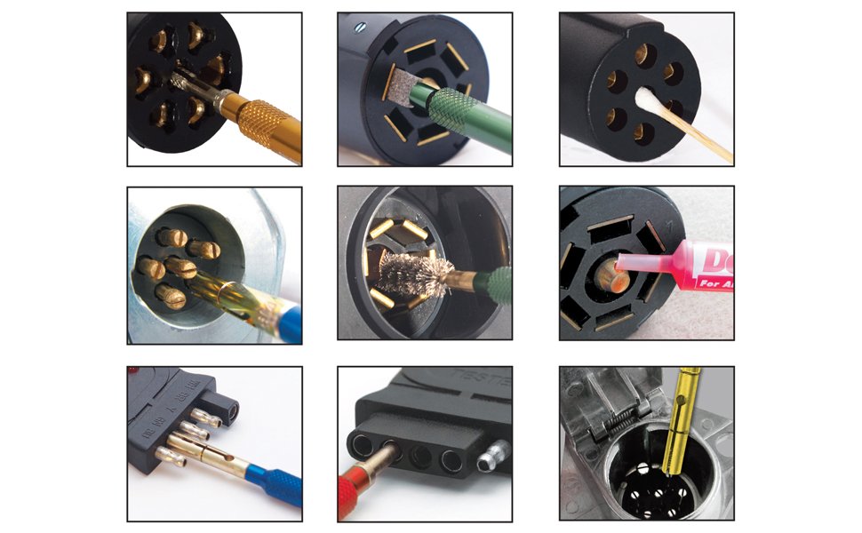

Have you cleaned out the trailer plug to ensure debris is not causing a short? Worth a try, it takes 2 minutes and costs nothing. I would hose it and then dry it with compressed air.

As TheDoc says, make sure the connector pins/ socket are surgically clean/ dry and the trailer plug internal wire connections are pristine.
Yes, have given it a very good clean and ensured all was dray. As I say it still works perfectly when I have the caravan connected, just annoying when I do not have a trailer connected.
