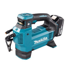

Some time ago I bought a portable and cordless Makita DMP 181.
For what I've used it so far - mainly inflating all four tires from 2.5 bar to 3.2 bar - it was powerful enough. But I still want to carry out a test from zero to three bar. As soon as I have some numbers I will publish them here.
The battery is an 18V/5Ah type which is a lot. I also have a 12V charger so I am independent when traveling. Since I might want to take other 18V Makita devices with me when traveling (radio/MP3 player, lantern, angle grinder, cordless screwdriver and -ratchet), the charger was a good investment.I think that for occasional use it is quite a good solution for multiple use cases. And I like to use it for my bike, my Honda scooter or my motorcycles.
Since it is wireless, there is basically no setup time.
I am not affiliated with Makita, but I am convinced of the quality and performance. Here are the devices mentioned above and which I consider travel equipment and thus worth carrying a battery charger on a trip. The inflator is linked above.
For what I've used it so far - mainly inflating all four tires from 2.5 bar to 3.2 bar - it was powerful enough. But I still want to carry Use the Makita 181 as well. Happy so far
