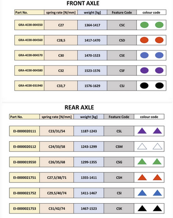

This table is helpful.

I don't know if you can overthink this stuff but coming from a long engineering background of course I would say that 🤓 You could throw on a lift kit with beefy springs but it'll be a rough ride with compromised handling when it's not loaded up. There's also the front driveshaft angle and increased vehicle roof height to think about.
Here's my suggested approach to achieve this in a managed way without doing a HD lift kit.
  • Before you do any/more mods get your vehicle weighed, including the front and rear axle weights. Clean out the vehicle but fill the fuel tank.
  • Do any planned mods that will grossly impact weight, like winch, roof rack, bar work, etc.
  • Load up the vehicle to your typical trip weight. Fill the fuel tank then weigh the vehicle again.
  • Do the math for the total weight increase and front/rear axle loads (see below).
  • Select and fit the new springs (also below).
  • Add rear load assist airbags for towing to offset the hitch downforce (you know where to look).
Robert Pepper did a deep dive into 4WD payloads using the Grenadier as an example here. Note that he is using Australian weight and load limits which might be different to other markets.
Spring Selection.
Look at the symbols on your current installed springs. Look up their kg weight rating in the table then select a new spring part number based on the weight gain and split. Check with your dealer what springs are available. This may still force you to go aftermarket but keep an eye on the spring length. The springs in the IA table are different load ratings to match the build weight based on the vehicle but they're not a lift spring or a HD spring.
Axle Loads.
Winch weight can reasonably be assigned to the front axle.
Rack weight and loads could be split 40% front axle and 60% rear but you need to think about what you carry on the rack and where it is located and adjust the splits accordingly. 40/60 could easily be 30/70. Weight acts downwards through the centre of gravity which shifts forwards during braking so if you must carry heavy loads on a roof rack (not recommended) then increase the weight assigned to the front.
Adding weight must be done within the overall weight limit of the vehicle and the axles. These limits vary depending on the distribution market and local regulations. Some markets do allow for an increase in axle load limits via a process.
Hitch Downforce.
This is less straightforward because it also moves some front axle weight to the rear axle because the towball is behind the rear axle. Towball downforce increases when towing downhill and during braking because the trailer pitches forward and leans on the towball. If you only tow occasionally I would do a front and rear spring upgrade based on weight gain and axle split then add airbags to manage towball downforce and rear suspension sag.
Opinion only. This is not a textbook.

I feel like I laid all this out just 4 posts back that way ☝️but it was a long post and TLDR is a thing in this glorious age or maybe it's not what you're trying to do 🤷

Hi @parb. Nothing in this list close to you?
Businesses that buy or sell products based on weight will often have a weighbridge. A weighbridge will give a total vehicle mass. Some can give a separate figure for the front and rear by driving part way onto the platform. You need to ask. For Grenadier and QM you want a weighbridge that is accurate in the 2500-4000kg range (5500-8800lbs).
Mobile vehicle weighing services are relatively common here (Australia). They have drive-on individual platforms like oversized bathroom scales that go under each wheel of the vehicle (and trailer) to measure the mass resting on each wheel and axle plus the total vehicle mass.That's the best solution for this activity.
If you cannot get your vehicle weighed then you're most of the way there using your 600lb estimate. @anand already recommended to go black on the rear. I'll step through it using your +600lbs estimate as an example for others.
A fair portion of your mods are adding weight over the front axle like the winch, armour, rack and front bar. You have upgraded the front springs already.
You have red rear springs. They are rated up to 1411kg according to the IA table. Blue springs would get you another 56kg (1467 - 1411). The empty weight of the drawers plus around 60% of the rack and awning weight would sit over the rear before you load them. Add a load and the weight shifts further rearwards, especially the drawers. Combined, that would exceed a 56kg gain over the rear axle so blue springs are out.
Black is 112kg higher than red (1523-1411) so black is your only remaining option within the factory spring range.
If you keep adding weight above what black springs offer then you need an aftermarket spring solution, including the HD Eibach springs.
Assessing for a front spring upgrade is the same process.
Black rear springs plus rear load assist airbags might be sufficient in some scenarios.
You need to stay under the rated axle limits per local market approval or get a rating increase if available (called a Gross Vehicle Mass (GVM) upgrade in Australia).
