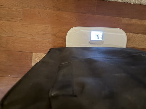

Checking now. I will put them on the scale and let you know. That is what I found them listed as but it could be off. The ones I have are 2 chairs in one pack and they are not as light as I would like:)
Are you sure about the chair weights... Total weight of two Expander chairs plus their carry bags should be no more than 10kg max. That makes for very heavy brackets...🤔
Unfortunately, yeah they’re 19.3 pounds and that’s with only one of the bags. I don’t think the other bag will add that much but a 19.5 pounds. On the bison gear website they say each bracket (3.6 kg) so two of those 15.9 lbs. Total is 34.9 lbs. I’m going to look at the front runner website maybe their new chairs are lighter as I bought these in 2021. But right now it looks like the two chairs alone plus the bracket would be too much.
So it looks like listing on their website is 9 pounds so two of those would be 18 and I guess the bag that holds it weighs about 1.3 pounds.
