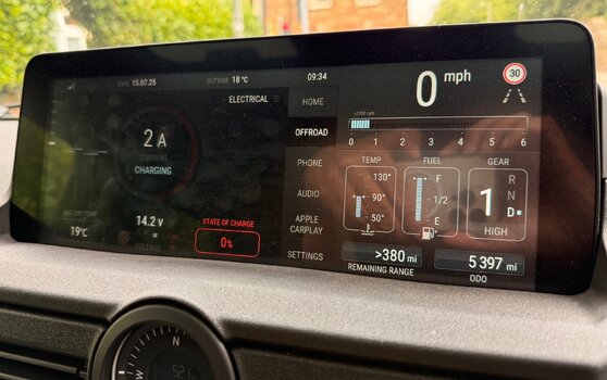

Helpful thread. Mine fluctuates between 0% and 43%. It’s a 2025 1924, Diesel which I picked up 3 months ago. It was my daily, but noticed a significant drop in charge 3 weeks ago. I called the dealer straight away, and last week I decided to park it up last week and use another car as don’t want it to let me down by not starting.
