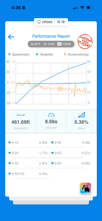

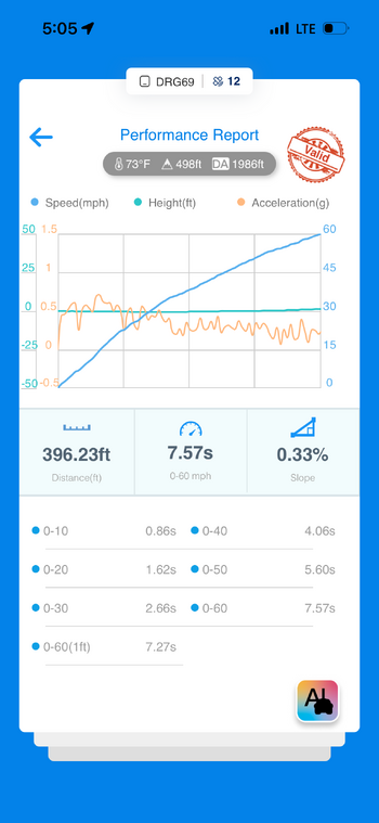

Just got my Bluespark from ORGG.
No info came with it but Marty called me immediately and got me squared away.
The shunted connector is for Bluetooth and goes in between the box and cables.
It definitely woke up the Ineos.
Ran two quick 0-60s using a Dragy (gps accelerometer). 1/2 tank, 18s, 4H with rack and drawer system.
I can’t tell if 1st gear/ 0-30 hesitation is turbo lag or wheel spin and ESC intervention, need to play with it a bit—the G drop at 10-15mph is likely ESC. But happy with the results, especially considering the Bluespark run was at 2x DA from stock. Very likely it should dip into the 6’s with the nannies turned off.
