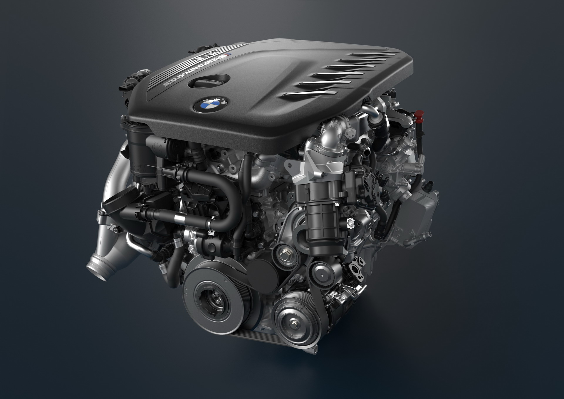

I thought I'd seen someone posing the question that without the engine variant, then we wouldn't know many details of the engine.
Does knowing this detail off the CoC help?
Engine code: B57D30.
Good one. Does that mean we get the higher rated version (320/340PS & 680/700nm) de-rated down to 249/530 respectively rather than the 280PS/620nm version.
I suspect that the Grenadier will continue to have a de-rated version in the interests of "longevity"...
Aye and that to me is a good thing. Will have all that I need. Trying to work out whether there's one type of engine which they have, and tweak it up/down on the power/torque scale or whether there's more than one variant to begin with which they then tweak.
I like the tuning Ineos has gone for
Maximum power is lower but also kicks in at much lower rpm
More importantly the torque comes in much lower RPM and is flat across a very wide range.
A work horse not a peaky engine
