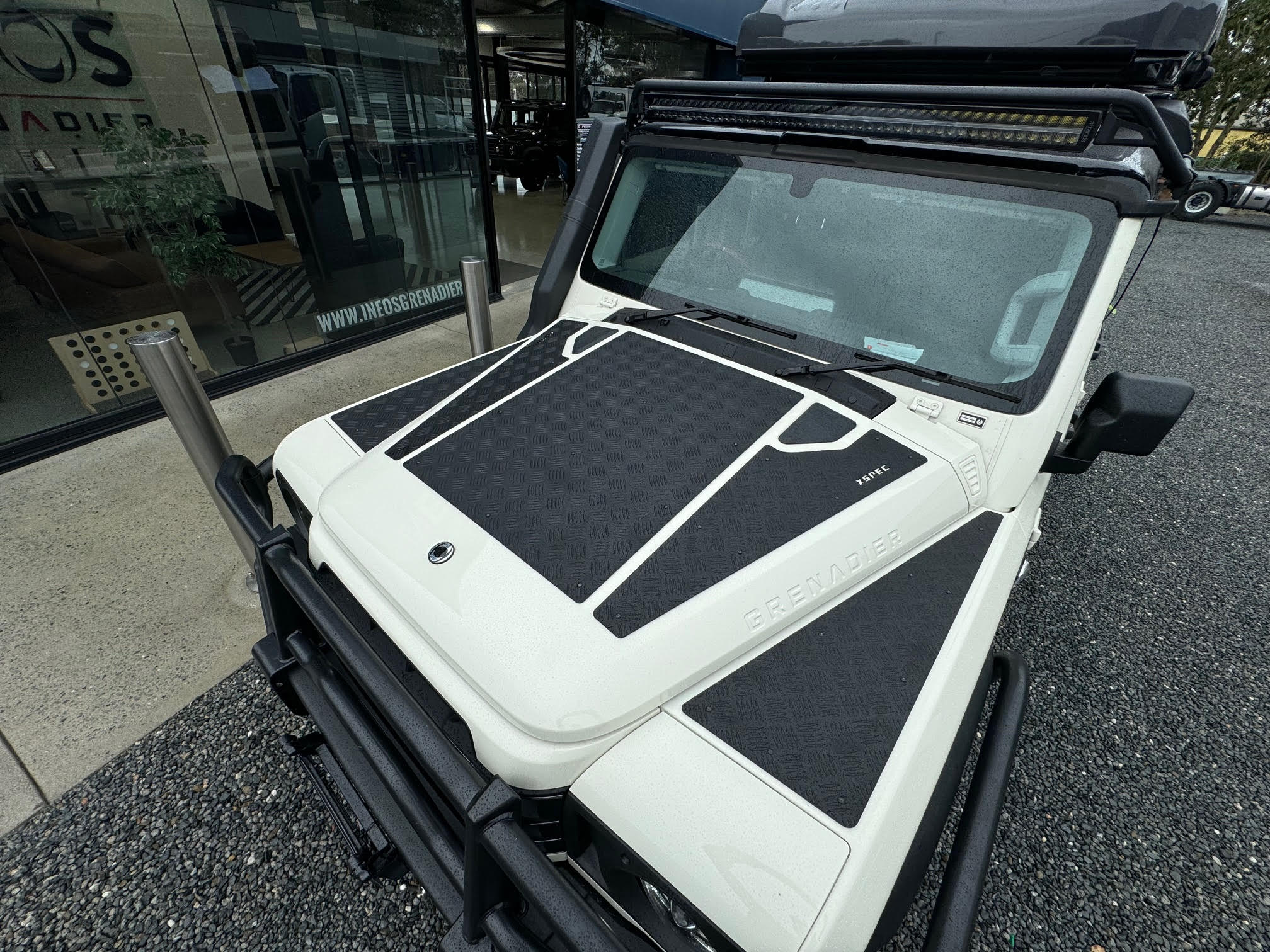

New XSPEC Bonnet/Hood & Guard Tread plate here.
From XHQ website:
  • Australian Made XSPEC brand by SLRV Expedition Vehicles
  • Available as Complete set, Bonnet set or Guard set.
  • Durable 2.5mm Aluminium Checkerplate
  • Powdercoated in Dulux Pro Texture Black to closely match Ineos Factory guard tread plate
  • Foam tape protection on underside
  • Black painted ‘All Aluminium’ sealed rivets included
  • Drilling template & Instructions
