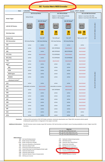

I could have answered this, as well.
ESC is mandatory in the EU since 2014. ETC is a necessary subsystem so that ESC can do its job. So ESC always includes ETC.

It's not that I'd discount your information, it's that Ineos should be documenting this system in a clear, unambiguous manner and - at the very least - in the owner's manual. At least up to their repsonse to my inquiry, that doesn't seem to be the case.
We've had several discussions on this forum where various members debate the existence of such a system. A video series on Robert Pepper's YouTube channel has often been cited as evidence of the existence of a Grenadier ETC system, but all I found was Robert saying something along the lines of "...oh look, the ESC isn't engaging..." when he expected it to. So that's not very convincing evidence.
