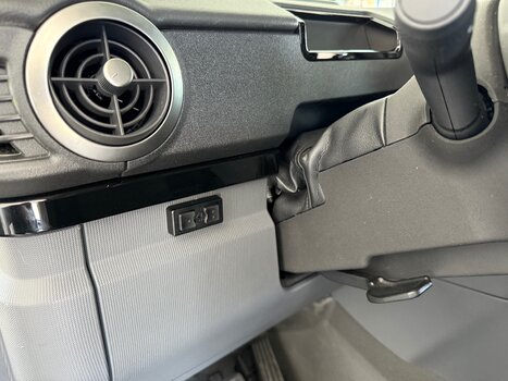

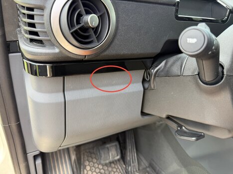

I’m adding a Homelink (the model below) and trying to figure out the best location for it. Seems like the location circled would work, but not sure if there’s anything behind it. Before I start pulling panels, anyone know?
I've seen other pics I believe you are good to go behind that panel. I'm not sure how much room for the Homelink box however.
Unfortunately there's a metal bracket behind that panel now that I look.
Oh is it up that high on the panel?? I know that seems to be where people are putting the Brake adjustment knob or in some cases I've seen some use it for After market radio knobs for selecting profiles etc....
There’s about 1/2” space between the parcel and the metal plate, so something shallow would work.
Well looks like I lied! I used my little scope camera to look behind the panel, I should have just removed it (a lot easier than I was expecting). There’s a plastic (not metal) plate / tab behind it. I just cut a notch out of it and it all fit fine.
