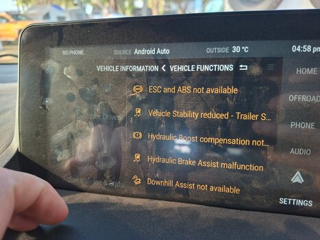

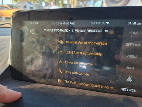

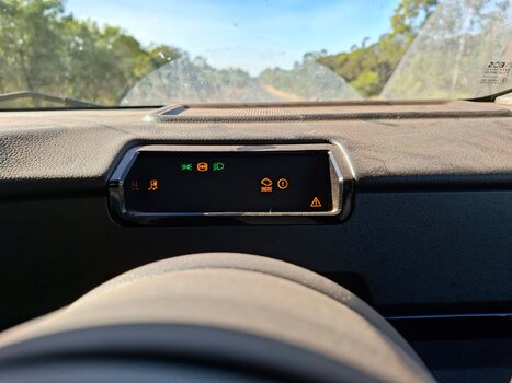

One interesting thing which happened was a stick getting flicked up behind a harness which connects to the rear diff lock and the rear left ABS sensor - breaking some wires and ripping some out of a connector. That resulted in the errors shown in the photos shown on the cluster and centre screen.
So there was an ABS fault - then a whole bunch or other errors. My understanding is that there is the ABS error (which is understandable given one wheel speed sensor is no longer connected) - then all the other errors are secondary due to the other modules no longer receiving an accurate vehicle speed signal from the ABS module (so the Trailer stability / downhill assist / uphill assist / power steering / engine and transmission faults). As an ex powertrain diagnostics engineer I was pretty disappointed to NOT see a message just saying something like "rear left wheel speed sensor open circuit". So no message which actually indicated the root cause of the problem. Apparently there was a code saying that on the ABS module but it does not get shown on the centre screen.
On calling Ineos support (and being 1000km from the nearest dealer) they said "are there any warning in RED? no? then keep driving!". Faced with a big wait for a tray truck or a long drive with no ABS I chose to drive. It was interesting to note that if you then locked up the brakes (was driving on lots of poor dirt roads) then the transmission module would flag a red error and go into limp home (seemed to be stuck in 3rd gear). That reset itself if you stopped the car and waited 20 minutes.
