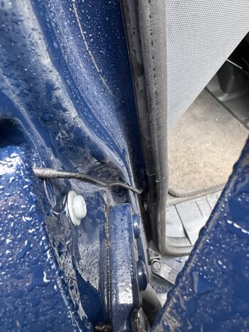

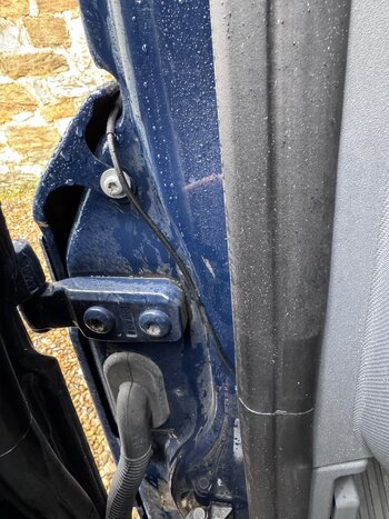

The way I ran the wires from the mirror to the firewall was across the mirror through the gap in the headliner on the windshield along the passenger side (Left hand drive).
From there I routed the wires to the area in the passenger footwell which you can follow from there.
1. Remove the trim pieces from the passenger side. Not entirely necessary because you CAN access the firewall grommet to get to the engine bay but you will have to deal with excess wiring from the included Wolf box bumper camera. I elected to tuck all of the excess wiring to the bumper in the passenger foot well.
2. Once you remove the trim pieces you will find a LARGE foam filler piece that is not attached to any thing and you can toss it in the back seat if you wish (makes things easy).
There are a couple of Grommets you can pass the wires thru the firewall. I elected to go through the larger one that I show here. I used a "pick" to feel where would go through the firewall and enter the engine bay. For ME this was the hardest part because you cannot fit your hand down to the grommet in the engine compartment.
For reference in the above pic the red arrow points to the FIREWALL, Green arrow goes to the front, Blue arrow shows the passenger side footwell direction. Orange arrow is where the Fish Tape went through the Grommet that I elected to use. This picture is from the TOP of the vehicle looking down for reference.
3. Once you have figured out how to maneuver the fish tape through the firewall, you HAVE to get the wire up to a place you can access it. The space is TIGHT! What I had to do is pass the initial wire PUSH through the firewall (I sprayed some Dawn Soap mix to help the fish tape).
When that is done you have to figure out a way to SNAG the fish tape and bring it up so you can actually get it! I used some old Copper Grounding wire to make a "hook" to snag the fish tape. (The red arrow shows where the initial fish tape went through the grommet and I caught it with the copper wire). NOTE: The red arrow above shows where to snag your fish tape. It was a pain to snag the fish tape but once this is done you can route the wires how you want to!

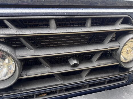

6. Camera Placement....I WANTED to get the "bumper cam" under the metal bumper but could not figure out a way to do so. I tested each of the "levels" on the grill and found out that where I placed it worked best for me.
I heated up a "Pick" with a torch and made a VERY small hole to allow me to use the Wolfbox screw and 3M tape to attach the camera. After TONS of back and forth, this location provided me with the best visibility in the front for rocks and such when I cant see them from the drivers seat position.

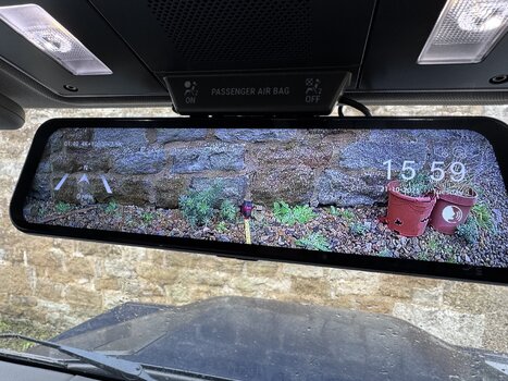

7. My final install, after testing each level of the grill I determined the ideal location for me was in this spot. I would have liked to put it lower on the bumper but this it my first iteration of camera placement. I still have some clean up stuff to do. The zip tie on the left of the grill will be fixed in the future but for NOW this works well as a temp solution.
I hope this helps folks in the future for installing a front camera.

1. Finding a way to adhere the cam to an area below the bumper was hard.
2. Below the bumper would have been ripped off with the wheeling that I do.
The nice thing is that the cable run can be positioned in another location....but I still fear that If I lowered the camera (if I could) would get destroyed when I rock crawl and wheel in different situations.
The position in the Grill where I placed it, gives the BEST view for each wheel and will not get destroyed.
My testing on placement took a bit to figure out.
If we are talking about the OPTIMAL placement for off roading.... was a compromise for certain. However if installing in the grill for off roading to see obstacles while alone, the placement I chose was the best to see things without having the bumper in the camera view taking up all of the frame in the mirror. I hope that make sense.

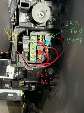

Need assistance….
So I have wired up the fuse taps to the dash fuse panel. Yellow B+ to FC04 (Clock/Theft Alarm/Logistics) and the Red ACC to FC14 (Ignition Switch/Steering Wheel). Problem is…the wolfbox does not turn on with the ignition. I can power on the wolfbox by pressing the orange power button…even when the ignition is off and with the key removed.
I have double checked the yellow and red wire fuse with fuse tap placement and they are where they are supposed to be.

I'm assuming you:
- have put a probe/voltmeter at the fuse locations you chose and confirmed that B+ and ACC+ signals are both available.
- have two fuses installed in each fusetap (and they're not plugged in backwards, example here).
- have done a continuity check across the additional fuses (the fuses powering the Wolfbox) to ensure they're not faulty. Try another set of fuses to be sure.
A good place to start troubleshooting is to confirm the mirror itself is ok by temporarily powering it with the included cig socket cable. If the mirror responds normally with the key in position 1 (ON/ACC) then the mirror is ok and it's a hardwire problem. If the mirror doesn't power on with the key then it's a mirror fault and a warranty claim.
The hardwire kit is a 12v to 5v DC USB C converter. You can test it with another USB C device. With the fusetaps installed, plug the device in and turn the key on. The device should show that power is connected/charging. Best to use something simple like a torch and avoid fussy cell phones that can require a specific current to connect.
Note: You might actually get power with the key on (ACC+ is connected) or off (B+ is connected). The Wolfbox goes into standby mode by testing that power is present on yellow and absent on red but a simple USB C device won't know the difference.
If you don't get a power connection on another device you then need to isolate a Wolfbox DC converter fault from a fusetap fault.
To eliminate a fusetap fault leave the USB C device plugged in and temporarily put the hardwire unit ground, yellow B+ and red ACC+ fusetaps directly across the battery under the seat (hold the fusetap 2nd fuse spades on the battery posts). If you have already run the wiring in and don't want to pull it out again just bring live B+ power and a ground signal from known sources to the fusetap using jumper wires or similar. If the device then gets power your fusetaps and hardwire unit are likely both ok. Temporarily plug the mirror back in and confirm operation with power applied (mirror on) and removed (mirror enters standby mode and records after a trigger event).
If you still don't get power cut the fusetaps off the yellow and red wires and apply power and ground directly to the hardwire unit wires. If you now get power the hardwire unit is ok and it's a fusetap fault. Replace one or both fusetaps, triple check the fuse health and the fusetap orientation are good and try again. Test everything before wiring it in.
Thanks Clark Kent…there is a lot there to digest. I tested the Wolfbox first with the 12v plug. Then tested each of the cameras and the gps while plugged in with the 12v.
I then tested each fuse location and determined which side had power to ensure proper fuse tap orientation.
With the fuse taps installed, the Wolfbox does power up…but only if I press the orange button. It only powers off, if I press the orange button as well.
I will have to keep going through your steps that you suggested….thank you again for the help!

Today I got round to installing the bumper camera for my Wolfbox Tri Pro. I’ve routed through the passenger side wing, avoiding having to pass the wire through the firewall grommet. I did this by routing it behind the rubber seal in the door opening (which is a press fit on the straight sections). Although the wire has a reasonably tight bend on it, it’s secure and shouldn’t rub so will hopefully last in this position.
The position of the camera produces a view from 80cm in front of the vehicle which is the best I could get without the bumper getting in the way.
