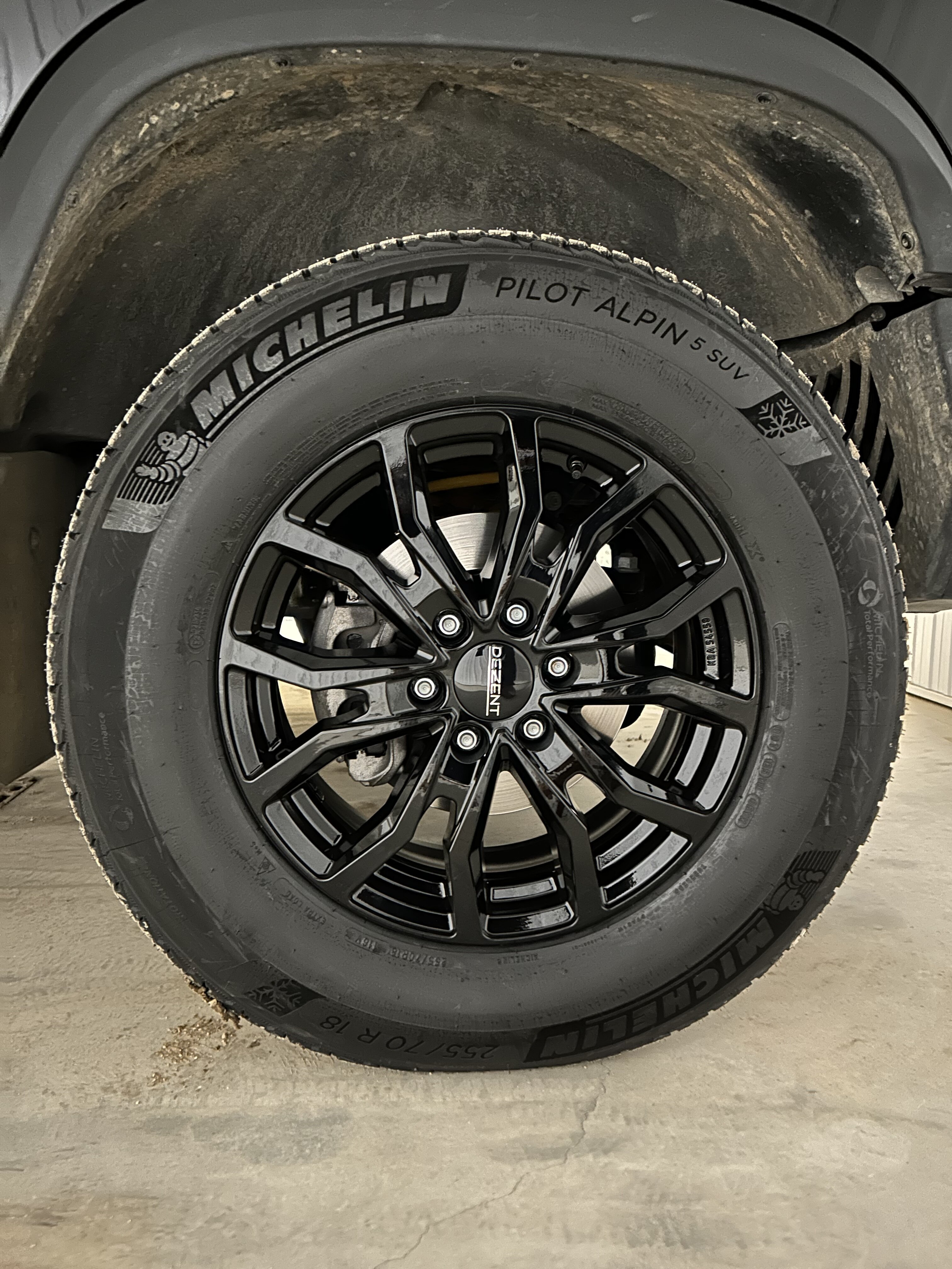

Apologies for the Chelsea truck rims :cool:
I had to take a quick decision if I will mount winter tire or the keep the 17'' Duelers. I live about Lake Garda with narrow and steep roads (and my IG is my daily driver) - it is not becoming really cold here but in the morning these roads can be icy. And I am driving between December and April around 10k km mountain roads in the Italian Alps. The Dueler 3PMSF are not too bad but I am scared going downhill with 2.8 tons in some wet and icy hair needle turns. In Europe no 265/70 R17 with 116 load index available - it stops at 115 which is means basically you should detract 60 kg from you maximum Gross Weigth - technically not a problem but for the law and the insurance in case of an incident.

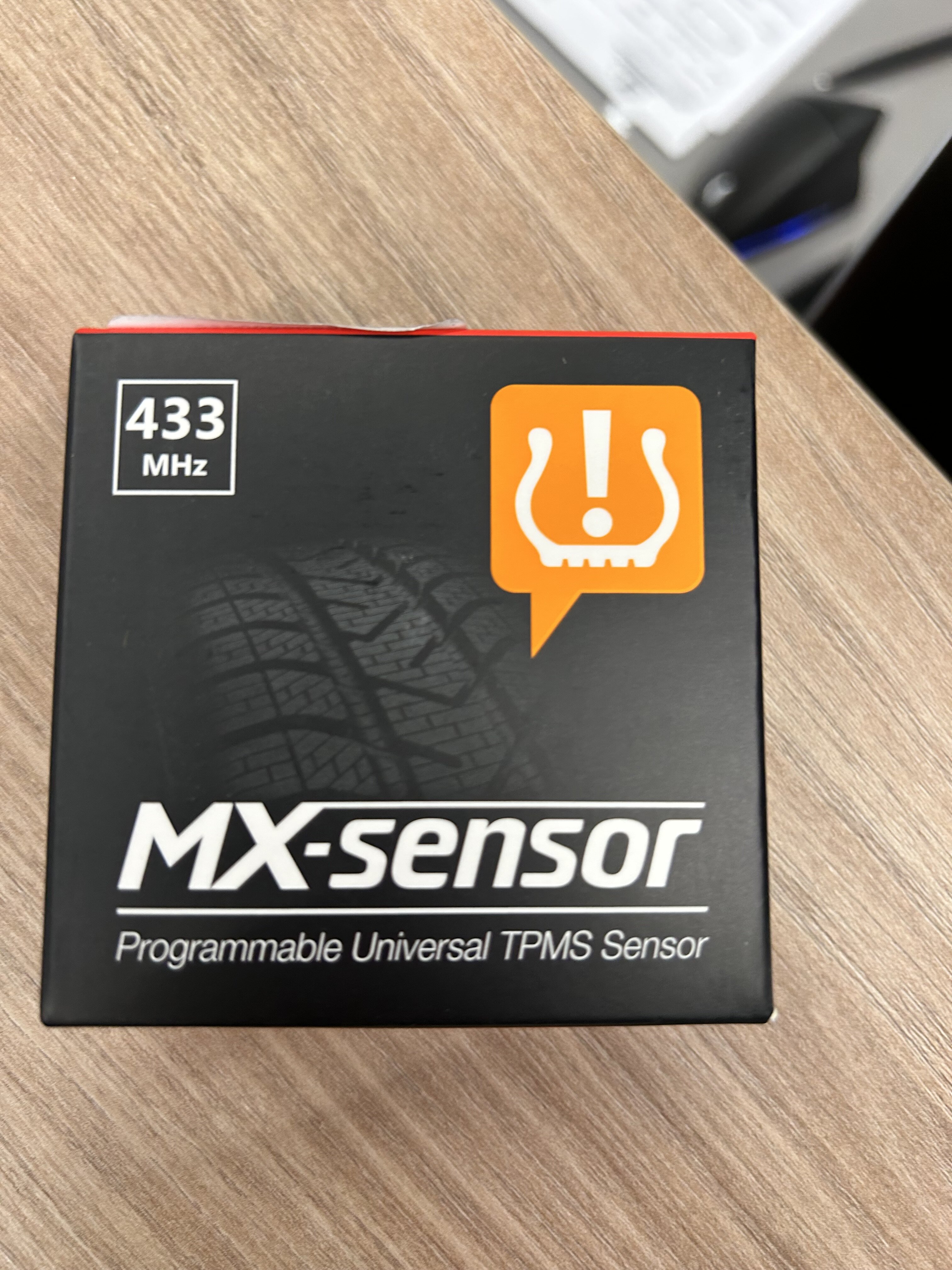

So the only available tyres I could find with the correct load index were 18" - so I would need new rims as well and of course TPMS Sensors. My dealer offered me the Michelin Pilot Alpine SUV in 255/70 R18 and 'Dezent' (part of the German brand of AEZ) alloy rims plus MX sensors (all available in less than a week - just before Christmas).
Yes, now with these rims the Grenadier looks like a Chelsea truck but behaviour and wet conditions with temperatures below +5 degrees Celsius is gifting me more confidence and yesterday I could test it as well on the snow the first time. What a GRIP! and I had never the impression that ESC did interfere.
And BTW the dealer could easily connect the TMPS sensor through his tool (yes IG is on the list) and not a single TPMS error message did occur after a TPMS reset.
