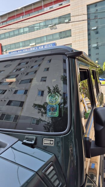

Yesterday, I had the windshield reinforced.
If the glass is hit by a stone in the center, it can be repaired, but if it hits the edge, it needs to be replaced.
So I attached a molding to the edge.
When I finished, it looked like a factory original.

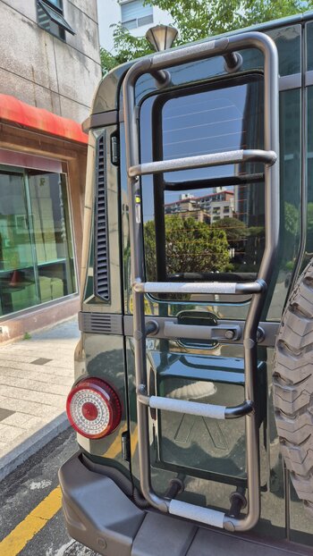

And because the ladder seemed slippery, I put some non-slip tape on the steps.

Translation is good. The rubber molding looks good. Is it held on by an adhesive tape? My windshield cracked starting from the bottom edge. I might try this when I get my windshield replaced.
The molding has 3M double-sided tape on the back, making it very strong.
Just came here to post about it. My wife got me the stuff from Amazon. Getting a new windshield put on in two weeks and going to redo it then.

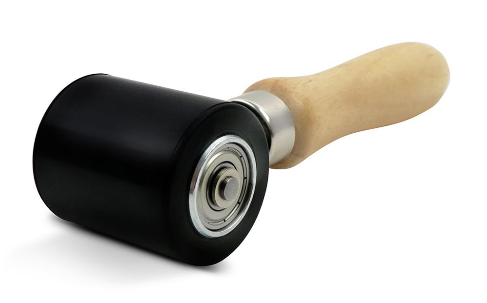

I used a Dynamat roller and trim tool to make the process easier on my fingers. I will write up the extra steps.

I had the rubbing alcohol for other work (applying stickers to windows). I know it cleans without leaving any film being left behind.
I also had the dynamat roller for my door seals. And I know it works. Much kinder on my fingers and allows me to apply more pressure than fingers alone.
