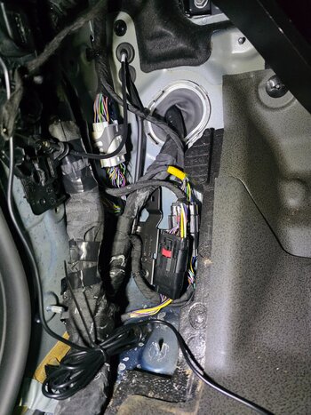

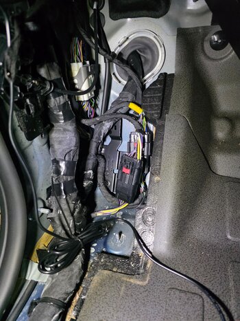

Well I disassembled the entire left hand foot well and did not see the INT1 wires. 🤷
Did you look on the underside of the loom where the plastic tape is, marked with the 3 white arrows? This is where the wire ends are normally attached - and often hidden under the loom.
Is there are fourth bit of plastic tape hidden by the wound up wire towards the bottom of the image? If yes, look there as well.
