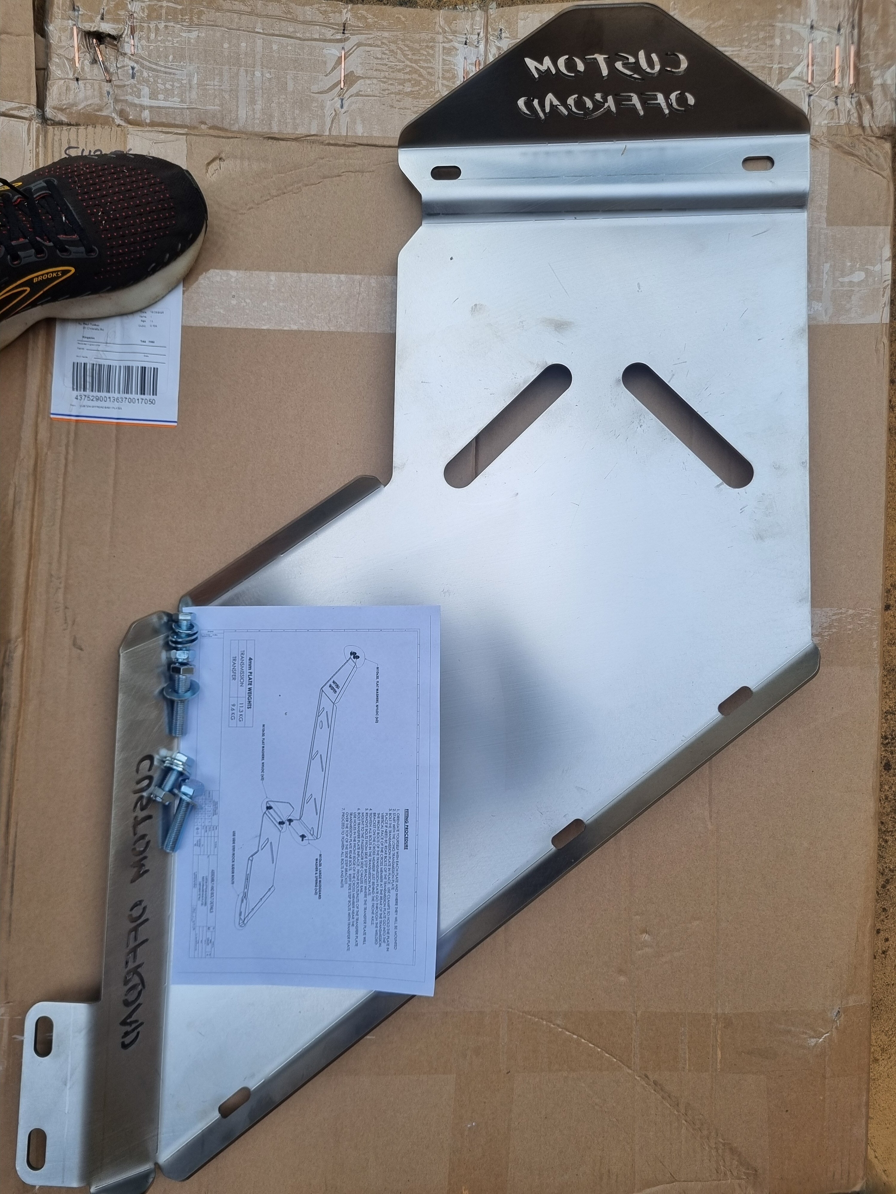

Finished the set from Custom Offroad
TC shield peace of mindView attachment 7890794
It's probably been asked already, but is there provision for oil changes on the custom off-road set?
I had ARB underbody protection on my DMax and it was a PITA to do maintenance so I ran some holes into it for the component drain plugs. A fumoto oil drain valve in place of the engine sump plug was also a good investment.
