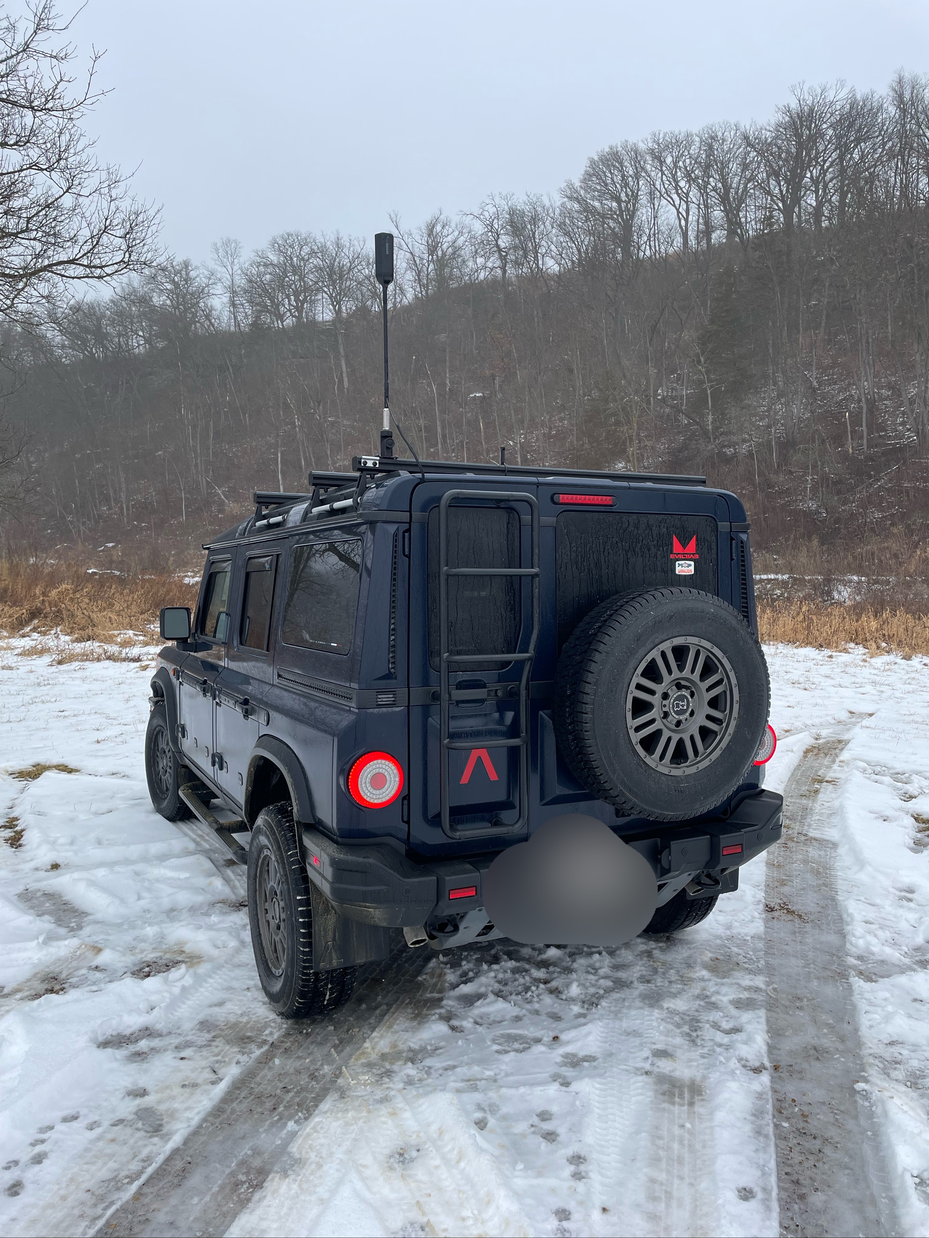

Yesterday, Santa got me the red Owl accessory rail, which I mounted. Early this morning, I drove out to the Driftless to scope out some trout spots for when the season opens in several days. Thought the ground was just wet when I got out on the driveway to put up the WeBoost antenna - black ice. Did a hard cartoon fall on the driveway - style points. Took some ibuprofen and shook it off. Came on an accident that had just occurred on the back roads in the middle of nowhere - SUV slid through a turn, went over the edge and flipped in a ditch. Checked the driver for injuries and talked her through it (after making sure there was no leaking fuel). The fire department came with extraction equipment (yay WeBoost). Grenadier with snow tires handled brilliantly on black ice asphalt, dirt roads and in the snow off-road. VERY thankful for all the advice to prep for my winter obsession with trout fishing. Thank you @Stu_Barnes and @Krabby for putting this together, thank you @anand for your WeBoost wiring advice, and thank you to everyone who weighed in on winter driving/tires.

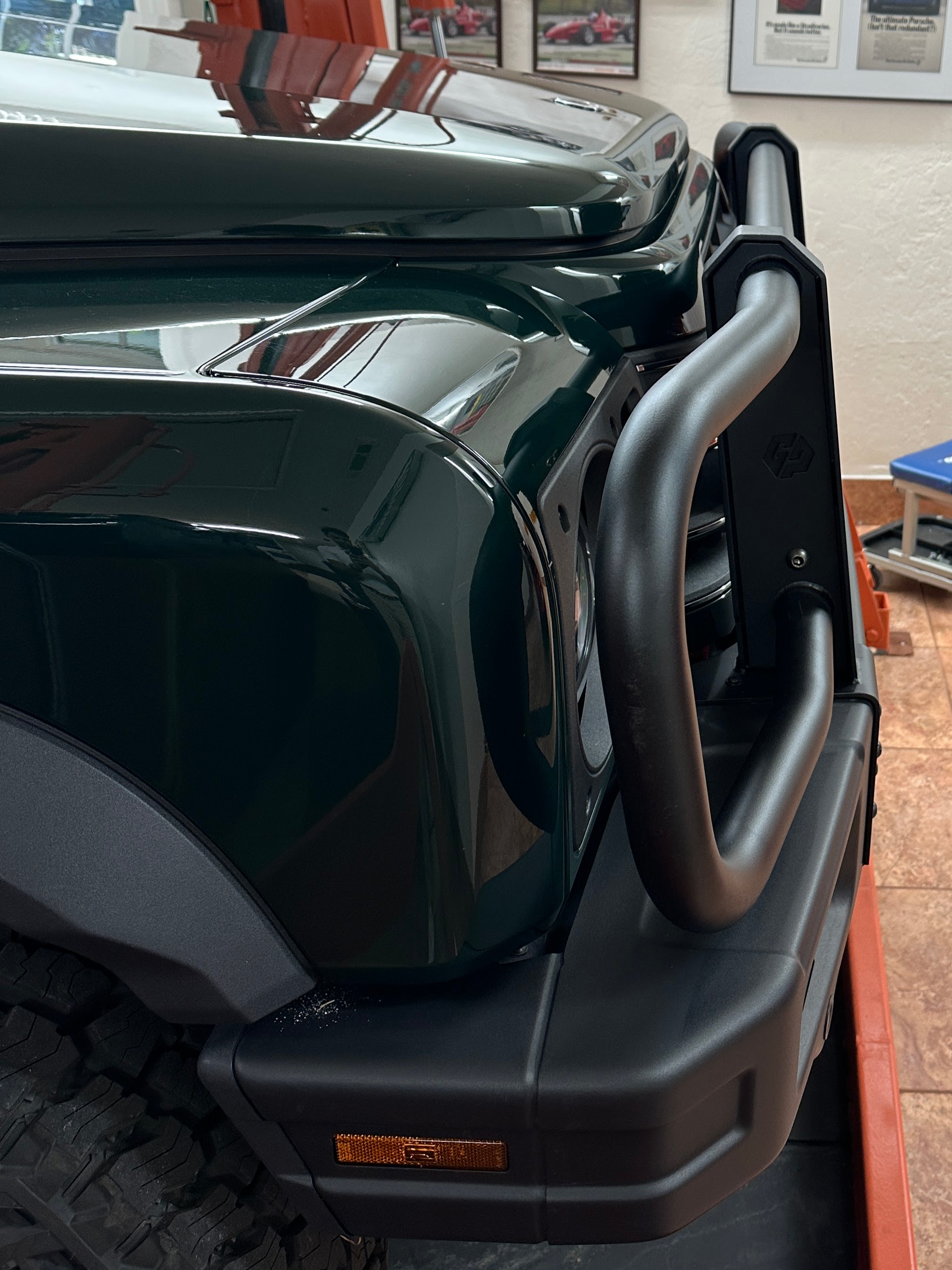

1. Fifteen52 Wander SV wheels in 17x8 et40.
2. Mickey Thompson Baja Boss A/T 255/85-17. No rubbing on this tire/wheel setup.
3. OWL spare relocation bracket set on one hole from furthest left, rear row, but could use only 3 of the 4 set screws.
4. GP Factor brush guard. Straightforward installation, fits great, looks good.
5. Fox non-adjustable steering damper. The 21mm side seemed to have a welded nut, so only one wrench was necessary there.
6. Urban Automotive single tube side step. Not pictured. Installation is still as challenging as described in posts from Q1 and Q2 2024; manufacturer has not implemented changes to tighten up tolerances.
7. Wolfbox rearview.
8. Warranty work: passenger footwell dripping, hood closure sensor broke off, TPMS sensors reading as one tire missing, check engine light related to fueling, steering pulled right.
Odometer rolled over 1k today. I like the car a lot off road. I might do some Dynamat in the rear cargo area and maybe a stereo upgrade, but otherwise it's now dialed in perfectly for me.

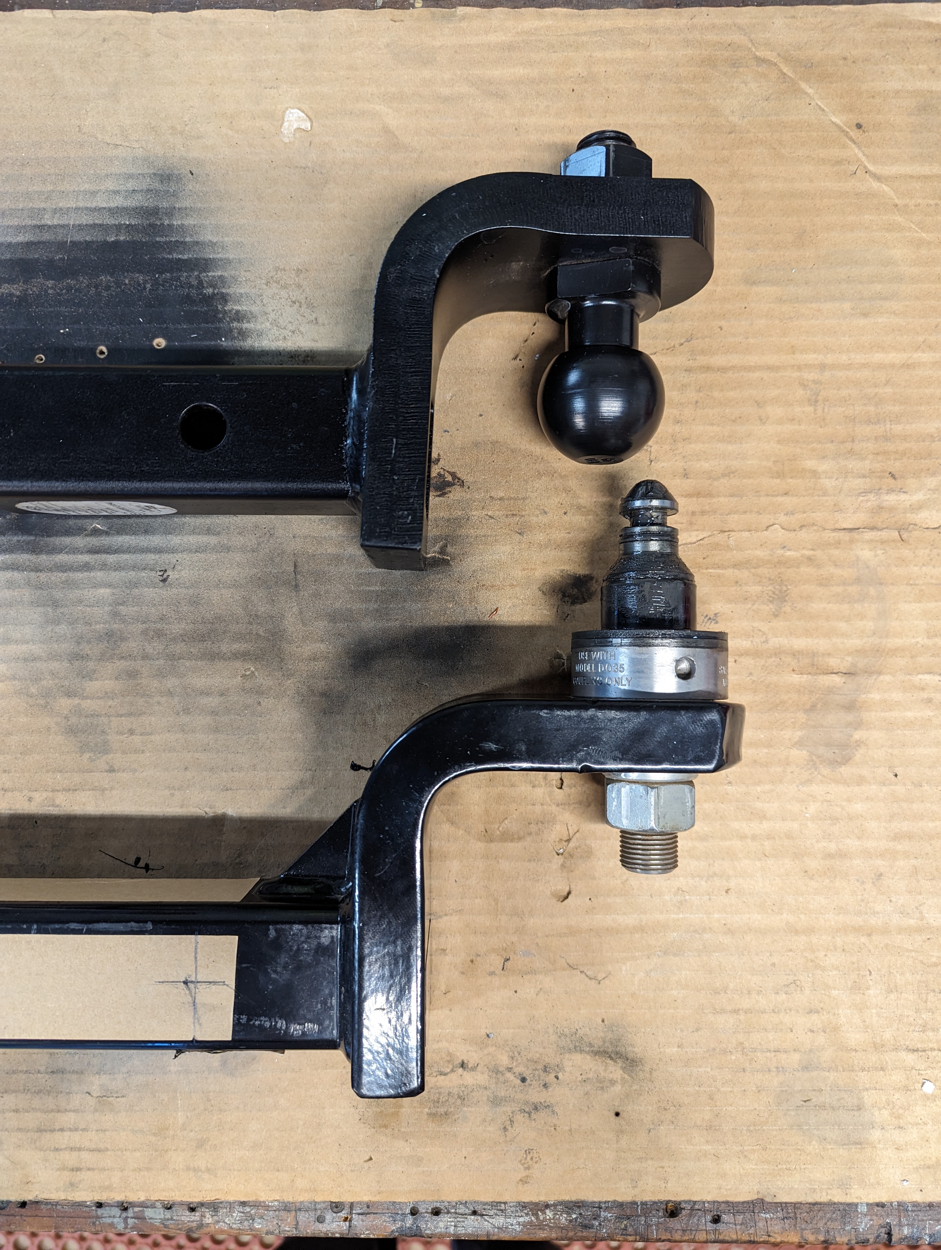

I have seen conflicting information on if it is a 1 7/8 or 2"
I used a Mr Hitches tow tongue as the hole on the supplied tounge was incorrect for my DO35, went in no problem.
Same. Specifically this one to get the correct rise to level out my hybrid camper.
I did need to shorten the shank and re-drill the pin holes due to the shallow Ineos receiver.

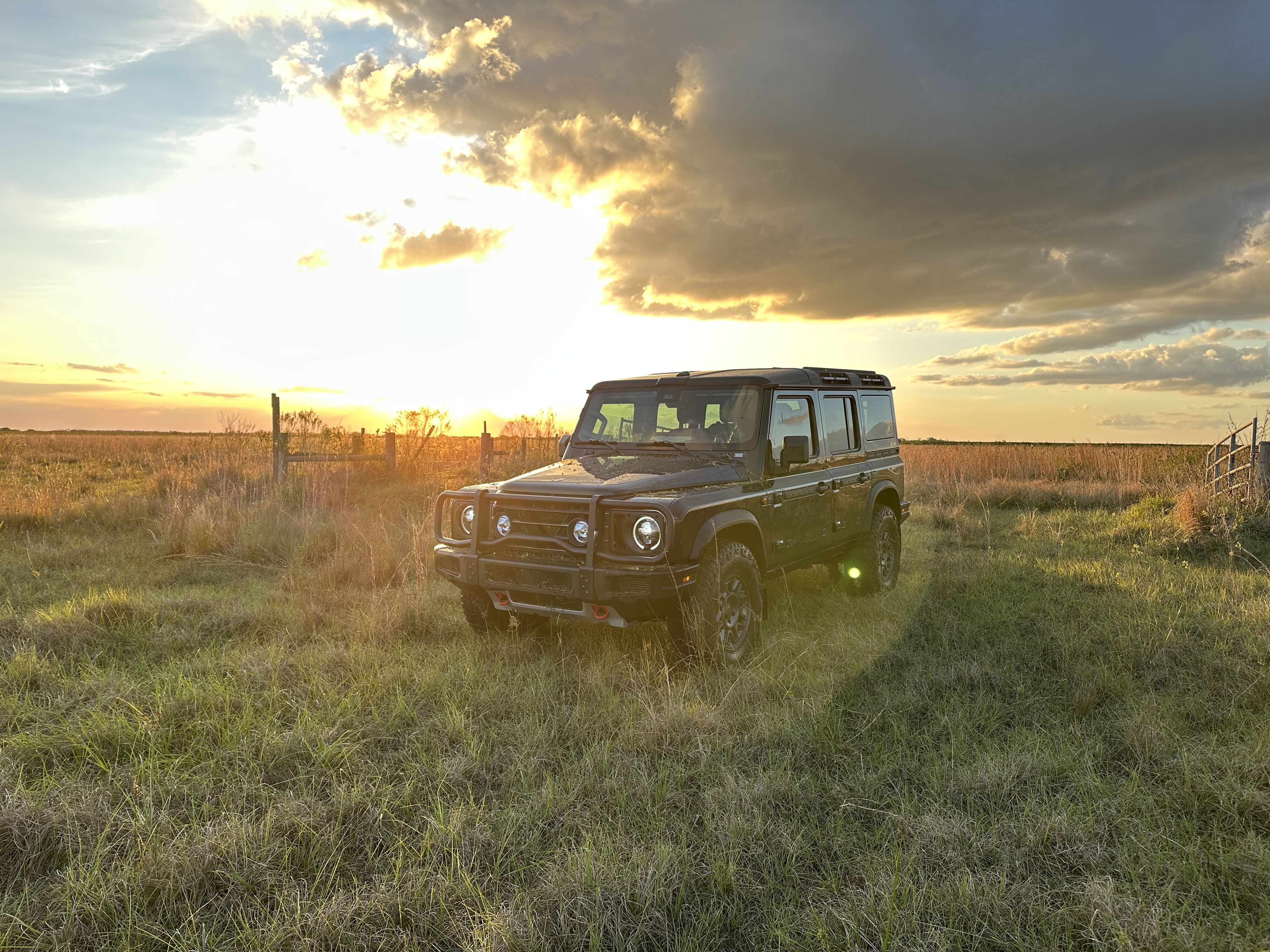

Well I made it to 365 DAYS !!!!
Its been an incredible 365 days with my INEOS Grenadier
So many fun and exciting trips all over Utah, Colorado, Arizona, Idaho, Nevada.
met some many great people along the way, looking forward to 2025
Safe Travels everyone
Day 365 - 29,285 Miles, More Adventures Ahead
