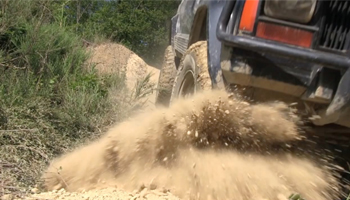

Played today a little bit in the dirt, at the offroadwerk beside the Nürburgring.
All lockers worked as they should, and we stucked nowhere. All inside mods stay on their place and our dog Abby the beagle was 100% relaxed at all times. My wife not😎
There is an off road track beside the Nürburgring?! I'm looking forward to a tourist lap there in September, although I don't believe my rental car will be suitable for the dirt
@anand You have the possibility to drive (guided) with a Grand Cherokee
All lockers worked as they should, and we stucked nowhere. All inside mods stay on their place and our dog Abby the beagle was 100% relaxed at all times. My wife not😎View attachment 7861012View attachment 7861013View attachment 7861014
Hi- ich wollte heute auch da sein, wie schon öfters. Leider hat sich mein Hund heute morgen verletzt. Das geht vor….. Es ist ein schönes kleines Gelände oder?
