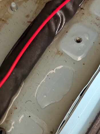

I have a RHD Grennie, we are getting a lot of water in the footwell of the passenger (left side)
There is much water it appears on top of the standard (no carpet) mat -
The mat itself is soaked and you can squeeze water out - literally been standing on it to get some of the water out - surely it shouldn’t take water in
it was raining a lot and it was parked on the level - at home its on a slight incline
Its cold so we aren’t using the Air Conditioning much at all
All the other floor mat areas are dry
Is this also that known issue(s) ?

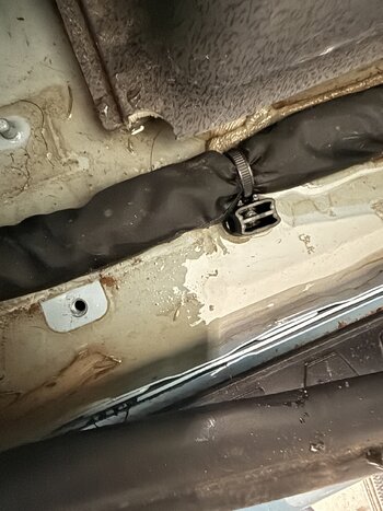

Below the rear door latch water appears there as well - currently its gone (towelled it out)

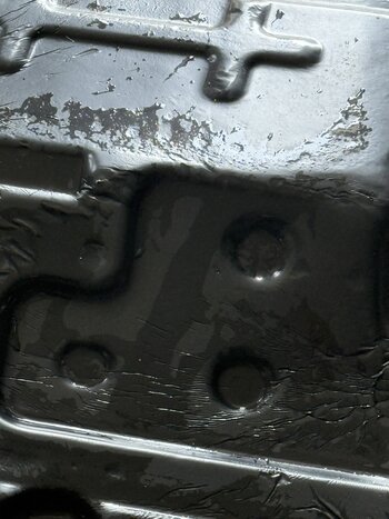

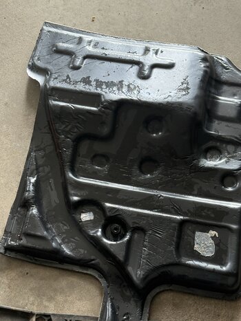

Photo of floor mat upside down - can see water coming out a small hole
Photo of rear door area
I’m having the same problem, both sides. To the point water is sloshing in the body rails. My mats smell of mildew. And no answers

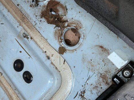

Can you get more info on the service action? It was my rear crossmember and inner body rails.
I've tried but the Dealer is treating the document like it's classified and the Service Advisor could not give me any useful information. Apparently they acces the plugs from the rear cargo area and use silicone to stop water ingress. They could not do mine as they did not have the silicone yet :cautious:. I had to completely strip my storage unit/shelves etc. for the occasion and they still were unable to complete the job :mad:
