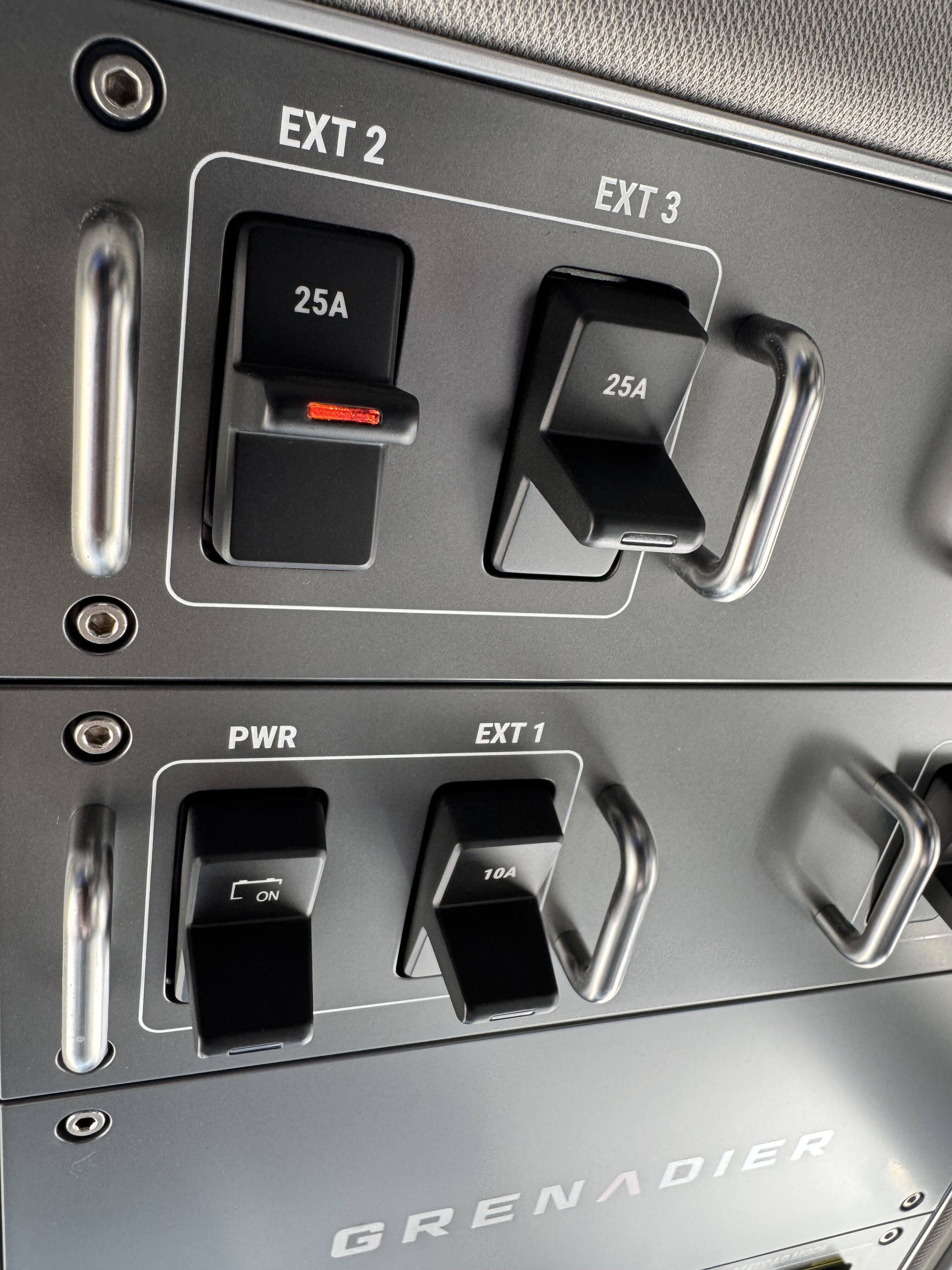

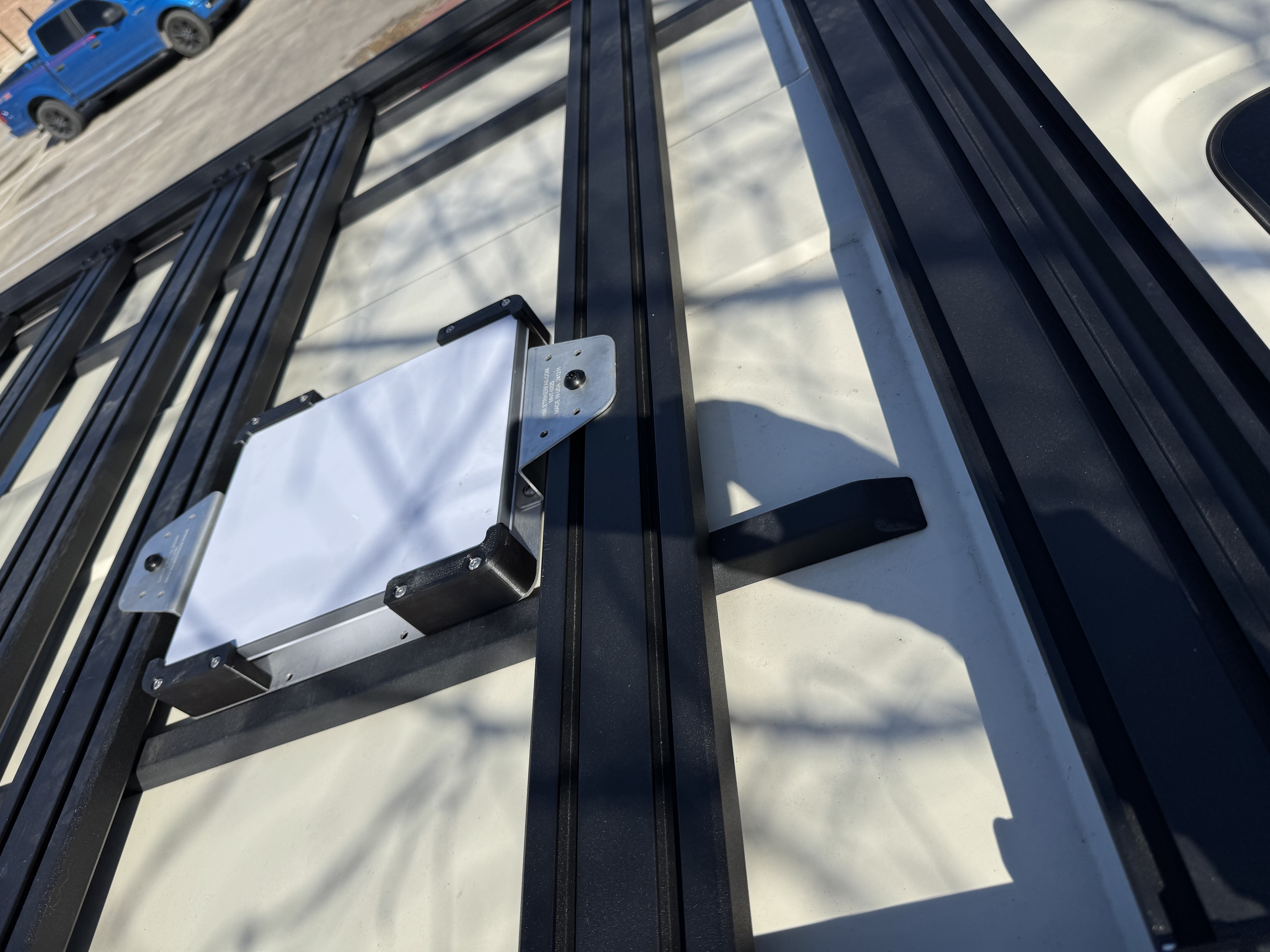

It’s behind the right glass, right where the rubber parts are. I ended up having to rotate it long ways with the roof. Reception has been plenty fast for me. As a test run I just used it in areas with no cell service. Four people could stream movies at any time without issue.
Thank you for your feedback. We may have misunderstood each other. I thought you had it in the interior of the vehicle. I plan to place my Starlink directly above the dashboard behind the windshield and still hope to get enough power.
