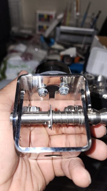

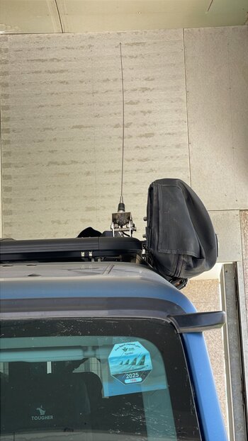

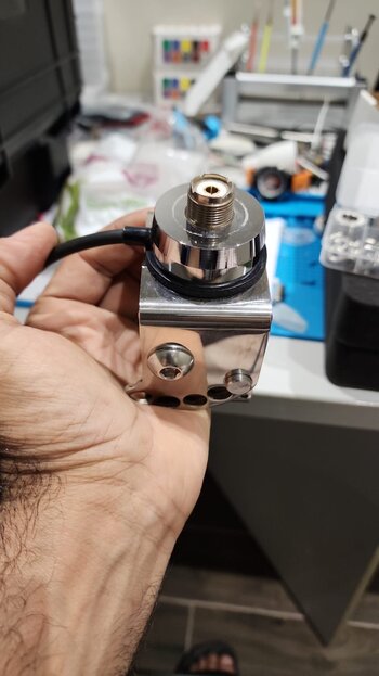

I ended up routing the antenna cable thru EXT3 grommet routed it inside from roof behind the top left airbag to the rear door pillar down with following the door sill to the unit beneath the driver seat (LHD).
The antenna mount is one and only I could get at the time that’s able to fold the antenna. Which I put on the roof rack.
