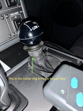

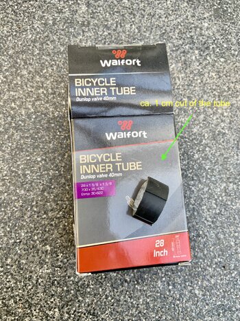

To prevent the pin from falling out of the shift lever, I cut a strip of about 1 cm of bicycle inner tube and wrapped it around the lever. It feels good, isn't as sharp as a cable tie, and doesn't stick like electrical tape and you can easily take it off if necessary.
I bought the new tube for €1.99. from one of these cheap dealers and also use this tube to make things like rubber bands to hold lashing straps or tools together.
Thanks, added to the links in Resources.
Brilliant. Inner tube cut lengthways is also good tightly stretched and wrapped around a leaking hose. It’ll help you bodge a fix until a new hose can be found. Also for wrapping around hoses to stop abrasion. In Africa and India I’ve seen truck inner tubes cut into strips to use as bungy cords and used to fix loads on bicycles and motorcycles

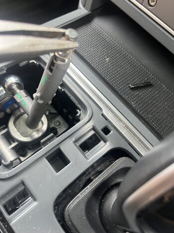

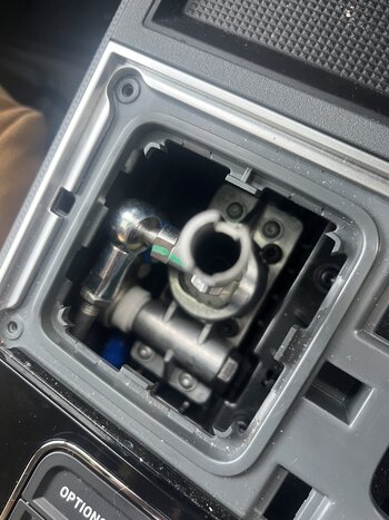

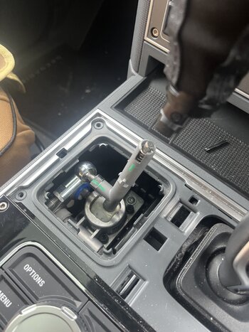

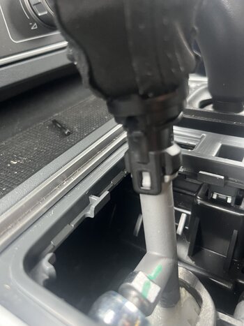

Just lost, and found my pin. Came out despite me constantly checking. Now, can’t get the pin to go back in. Removed the fascia panel to get access to the linkage and pulled up the gator. Still can’t quite work out what to do next.
Having removed the small shaft using a pair of pliers, I note a flat spot machined out to create a face. Didn’t notice if this flat face should face the front or rear when reinserted. Can’t see any logical reason for this machined face. Anyone with advice please?

My transfer box was working very well. Only issue was the time taken for Front / Rear diff lock warning lights to extinguish.
My current issues relates purely to the lever and its pin drifting out. I can see the machined face I am referring to interacts in some way with a plastic component inside the shift knob.

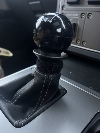

All back together and pin secured in place with a Velcro cable tie.
