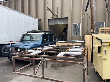

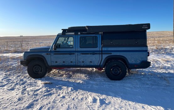

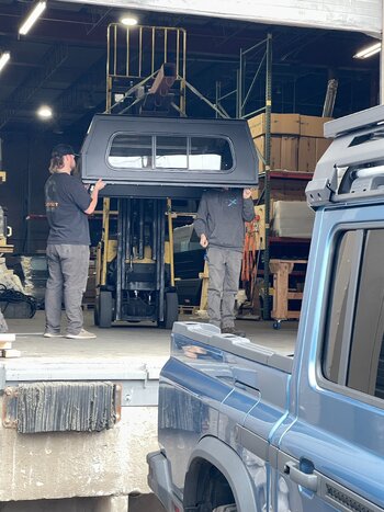

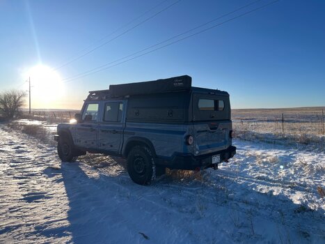

Some changes are taking place with the Build.

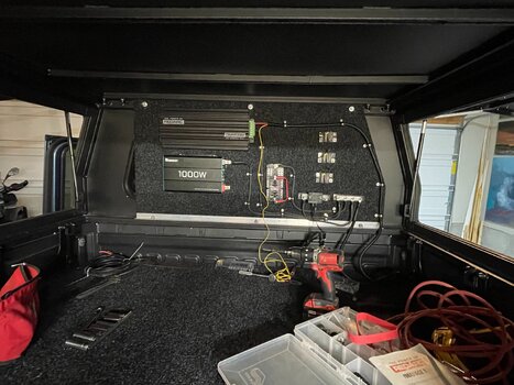

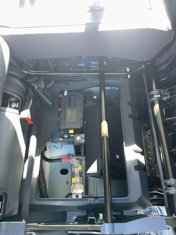

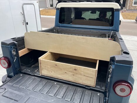

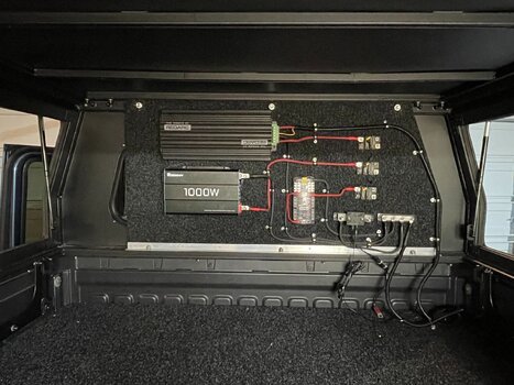

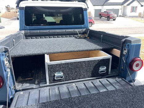

REDARC Electrics and Canopy/Topper from Dirtbox were the main focus. Moving the spare tire and building out a deck with pull out drawer was important.
I tapped the secondary fuse block to power the Manager 30, and there were factory openings in the cab and bed to allow wiring without any drilling.(y)
The Topper is robust and made of extruded aluminum. With so many access points to allow molle panels and places to bolt kit to. Making a strong and sturdy bulkhead to fix the REDARC kit and switchs to was pretty straight forward.
After the Canopy was fitted I'm find some success in sealing the massive opening between the tailgate and bed. Only after a good dusty shakedown run will I know if my attempt proves worthy.
More details coming soon.

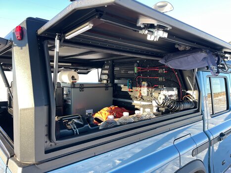

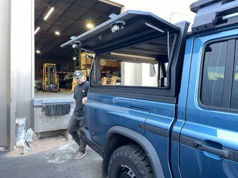

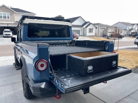

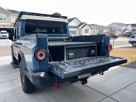

I've came to completion of the main build of the truck. The DirtBox Overland Cap is one of the key components to the build and made it possible to install kit with relative ease. The modular design made it so versatile to configure the space to meet my requirements. A big thanks to the folks at DirtBox for their part of making this build happen.
I'm contemplating rear spring upgrade to gain just a tad bit of height lost with the weight of the cap and contents.
A trip to test the truck and build out is eminent and if something seems inefficient or simply doesn't work I'll make changes as needed.
My biggest concern with the truck is the rear overhang and departure angle vs the wagon. But we'll see.
Trip photos will soon follow.
Cheers

Looks big, with lots of storage. (y)
By moving the spare under the deck and the addition of a huge floating drawer (32"x28")there is a lot of usable space.
I'll take it to a scale soon to find out what my GVW is.
I think it's now a proper tourer.

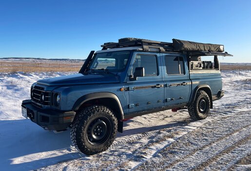

Coming from a wagon to a QM takes a little adjusting, not the just the turning circle. The ride is a litte different, as someone mentioned it's a little jittery, but I think thats the springs with the longer wheel base and no load. Heavier by 100kgs (the QM) but that is without fridge/drawer system. I'll be 3500kgs when its complted :oops:
I have to agree with your comment about the ride being "Jittery". I found it to be very much so and almost unacceptable concerning ride comfort. But once I installed the bed cap, the kit build out with the additional weight it is now really settled and quite nice riding. Maybe more comfortable than the Wagon.
Turning radius is probably it's biggest drawback in tight situations and does require getting used to.
The QuarterMaster does feel quite heavy, yet power delivery with the Petrol 3.0ltr motor is responsive and acceptable. And I live at 7,000ft in elevation.
I really like the additional space, yet I'm really trying to keep the truck as light as possible. That's why I personally choose not to do a Roof Top tent and keep the weight below the roof line.
The Bush Company Awning is quite heavy (Around 30kg)but I never felt it effected handling too much on the wagon.

I like how you did your electrics. That’s my next move to plan out. What brought you to the Manager 30 and the Renogy 1000w inverter? I love that the Renogy inverter is a much better price than the Redarc version. Any big tradeoffs?

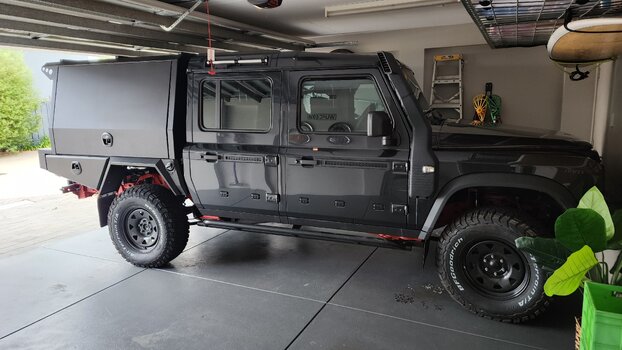

This is why I think I have the perfect setup. All weight over rear wheels, 19 gallon water tank and battery system. Rear tire is mounted underneath next rear axel. Suspension sagged only 1/4 inch.

Thanks, I've moved the Manager 30 in 5 different trucks. 2 Defenders, Jeep Gladiator, My Ineos Wagon and now the Quartermaster.
The thing I like about the manager 30 is that it'll take inputs from the Truck alternator (Trigger source is mandatory for full secondary battery charge. At least that's my understanding.) Solar input, and house mains input.
It's simplicity makes it pretty easy to install providing you have some understanding of auto electrics. At times I wish I had the REDVISION but the simple monitor of the 30 gives me all the information I actually need.
Down side is wiring the accessory switches. That kinda complicates wiring ancilleries.
I like that all the working parts are in one unit less the supply circuit breakers/fuses. So far,, (Knock on wood) the Manager 30 and 100ahr litium battery has been trouble free since 2001.
The inverter was bought (1) Product Reputation, (2) and cost. I don't use it for anything thing near capacity so I can't say it would preform under higher load demands.
