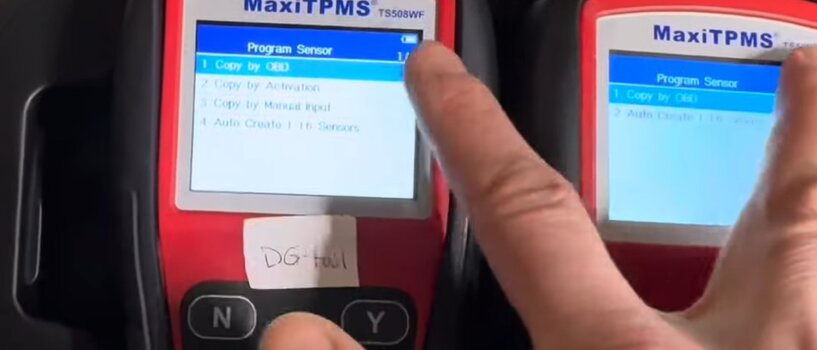

Looks you have different sensor and vehicle versions. I presume the entry “Sys Software Version“ refers to the updated software and - interestingly - we have the same version. Are you looking in the Advanced menu for the actions you can perform (that’s where I see all the capabilities I mentioned in my previous post)?
This shows a image with and without the features:
The software on the left has "copy by activation" and "create by manual input". The software on the right had these options removed.
They are both TS508WF models.
