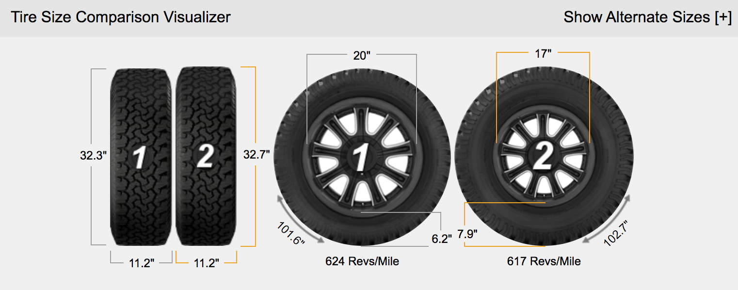

I've scrubbed the entire forum and read through several posts, yet, no ongoing talks about the 20" rims. There was a mention once but only one response on it.
I'm not looking into wrapping them with 35in tires, looking more into 285/55r20 BFG KO2s which have a diameter of 32.3 in. Seeing that several people have already upgraded to 285/70r17 I've seen here, I assume no lifting is needed since 285/55r20 would be smaller?
I'm ready to purchase but I don't have enough information about whether it's the right choice or not. I understand the obvious why 17" is better than 20" but how big of a sacrifice to opt in for the 20"? Thoughts, opinions, and rants are much appreciated!
1) 285/55r20
2) 285/70r17
If you intend to mall crawl then fine. If you intend sand or rock driving then don’t do it, you need the sidewall for airing down for extra traction, to protect your wheels and to make the ride more comfortable. I went 17”, 18” would be the maximum I would go if you intend to offroad
In my experience, I think sand driving might be ok (with some common sense). I've made a few beach trips in my wife's Range Rover Sport with 21" wheels. Air down comfortably to 18 psi and had no issues even in deep stuff.
Yes you might get away with sand although the profile of the tyre makes a big difference. My Brother and I effectively had the same car but my wheels were 18” and his 18”, we webt to the beach together and both aired down to 18psi, I had no issues at all, he bogged several times until we dropped his to 14psi.
