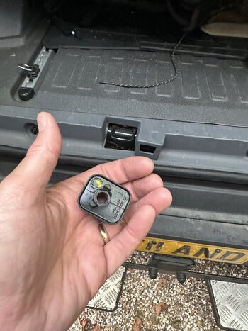

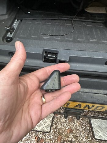

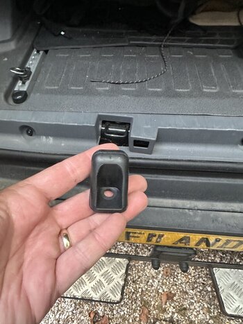

Hi. I have just found this in the back of the Grenny, I think it might have fallen off one of the back doors?? I cannot for the life of me find out wher it is from 👍

it's the smaller little door protector. Fits on the inside of the bigger boot door to save damaging the little one if you close them in opposite sequence to intended. Replace with a bolt and large washer to stop the part coming off the bolt head as has done with yours. Search on the ground for a bolt. There's a thread on it on here somewhere.
Common issue, add a washer to the inside of the rubber. It's from the larger door, it stops the door from closing on the small door if that is closed

Hi thanks. That was the first thing I thought but that one is still there 🤪??

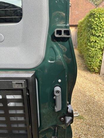

no two on mine. checked around a bit but couldn't see a spare.
