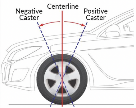

Concerning possibility of wandering steering with solid axles and recirculating ball gear, a friend (who bought the first Land Rover IIA in the Boston area many years ago) reminded me of this: Caster Action.
Caster is the angle of this steering pivot, measured in degrees, when viewed from the side of the vehicle. If the top of the pivot is leaning toward the rear of the car, then the caster is positive, if it is leaning toward the front, it is negative.
If the front wheels are positioned forward of the upper ball joint/strut mount, that positive caster produces a self-aligning torque on the front wheels and tires. This is a fairly complicated engineering concept, but the idea is that positive caster creates a tension that wants to return/keep the front wheels pointed straight ahead while at speed. You experience the benefits of positive caster and self-aligning torque every time the steering wheel naturally “unwinds” back to 12 o’clock when exiting a corner. And without positive caster and the resulting self-aligning torque, the vehicle would be very inclined to wander at highway speeds. (thanks TireBuyer.com).
My friend said his Land Rover was set up with neutral caster in order to make it easy to turn the steering wheel when moving very slowly in dirt or mud. With a positive caster, when you turn the wheel you are actually scrubbing the tire sideways, increasing steering effort. The tradeoff was that the vehicle tended to wander on the highway. The Rover's neutral caster made the steering wheel easy to turn. No scrubbing, but it did wander on the highway.
Since the Grenadier has power steering (and the rover did not), ease of turning the steering wheel at slow speed would seem less important an issue with power steering.
So... can the Grenadier’s alignment be adjusted to add some positive caster so that straight tracking is enhanced as well as re-centering after a turn?
Doing what you suggest has it's issues and I think it was done to LRs that were old and tired to make them steer as straight as possible, if the IG is anything like the 70 series it won't be an issue. There should be no wandering per se. The only problem I had with wandering RB steering was an 80 series that had done 500k klms and the front end was cactus.
