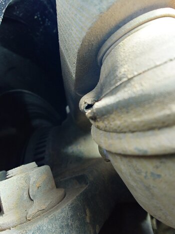

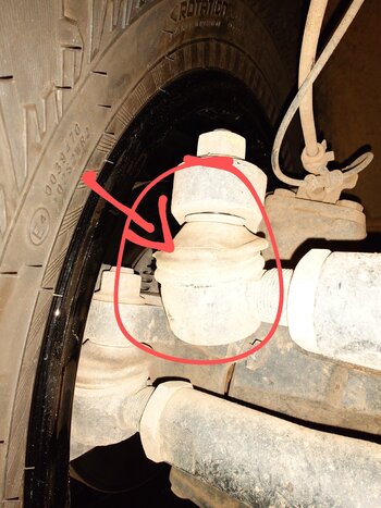

Anyone knows the specs of the ball joint? The boot of the Ball joint has a hole in it, and Ineos wants me to buy a whole new "steering rod", because they say, you don't get the ball joint alone.... i can't imagin that....

I read your post and thought that cannot be right because a ball joint is a wear item. It's a consumable.
So I looked it up in the IPC.
There is no parts breakdown for the tie rod or the drag link. This is LHD MY23>

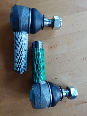

No warranty at all, but I found them at Milltek. If you are looking for those, catch up with the Milltek team! They are awesome!
I got mine now. Got them from them.
That's a good find @Rusty_hombi
Here's the link if anyone is looking:
